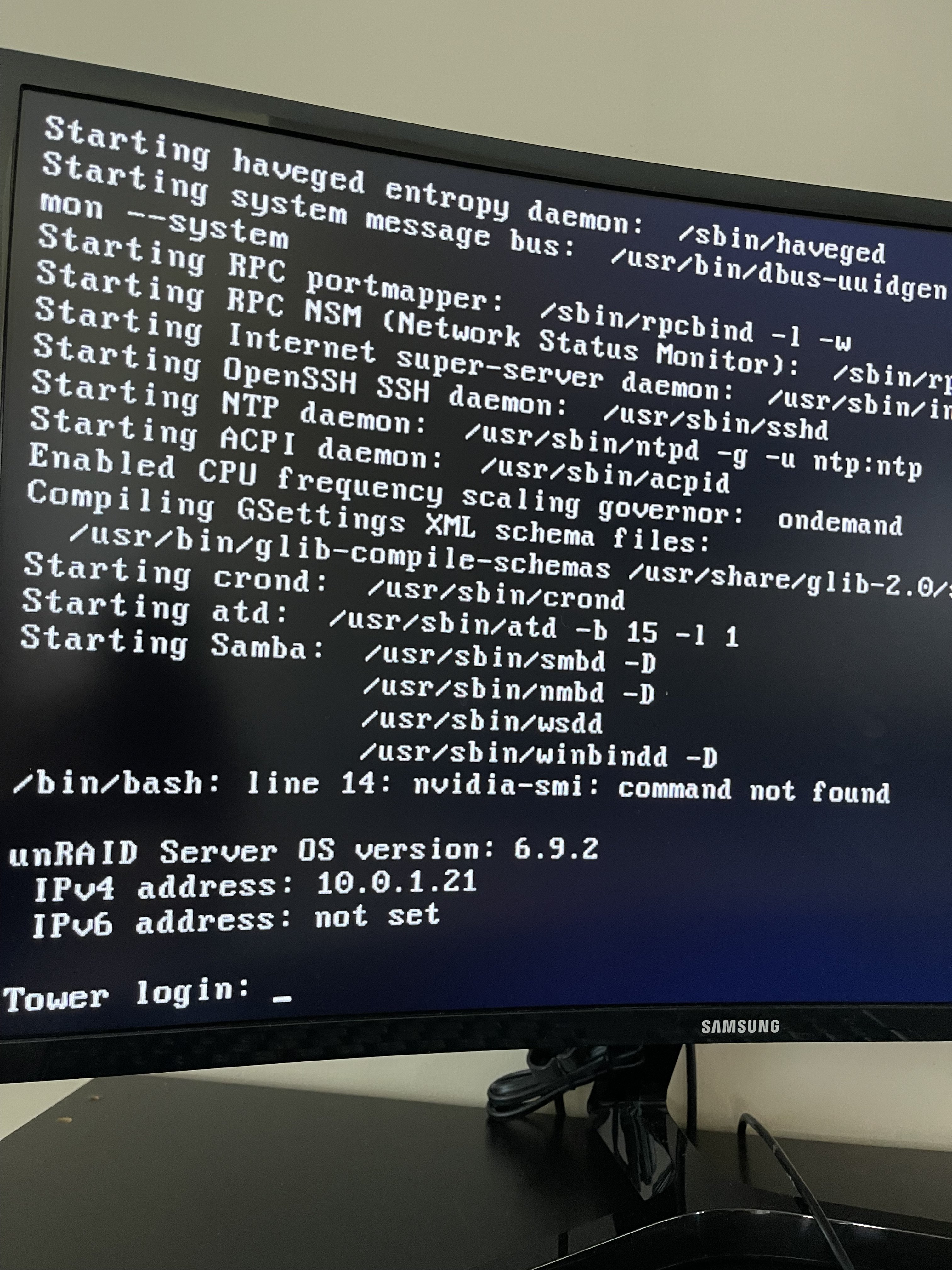

IMG_0886.thumb.jpeg.fc2e5738bafbb0c64a2b5cf87e2b1cdc.jpegI moved my PC to a different room. Took advantage and cleaned all the dust.
It’s boot up and shows my IP as normal. But I can’t connect. Made sure the Ethernet switch is connected to Ethernet. By using my laptop.
although the boot show this. See image. Not sure this is what is holding me from accessing my UI.
Hi Jorge. I can’t access my UI through 10.0.1.21.

I couldn’t SSH with Ip. No connection
The keyboard and monitor are attached and booted with same Nvidia fault
/bin/bash: line 14: nuidia-smi: command not found
It won’t let me type to log in to get to  “ Diagnostics”

6.9.0-beta22 is really old, I would not go anywhere near that or its config folder.
Stick with your current version and current config folder. In that config folder, carefully edit ident.cfg and change:
USE_SSH="no"
to:
USE_SSH="yes"
Then boot the system. With that change you should be able to SSH to the system and run 'diagnostics'
Sorry, I am realizing this is 6.9.2 (I just added that to the title). It has been years since most people have looked at that, especially with the version customized for nvidia.
You might have luck booting in safe mode, or reverting to stock Unraid 6.9.2 rather than the custom nvidia version.  Maybe someone else will have more specific advice.
Ultimately you'd want to upgrade to the current release to get back into a supported environment.

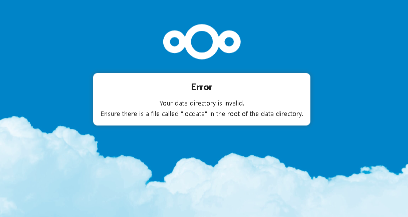

i am not sure if you can help with nextcloud now with this error or should i open a new thread?
see attachment
I cannot, best to use the support thread/discord, assuming one is available, click on the container:
