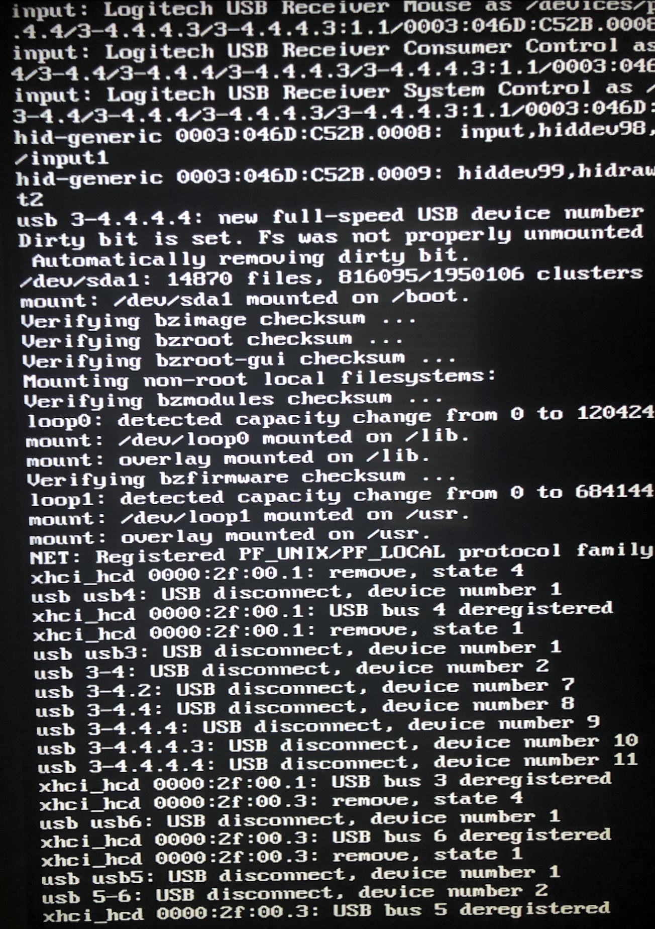

regarding the terminal it just does nothing and is cut off as shown in the photo. I’ll try a different keyboard just to make sure it’s not an issue with the wireless dongle I normally use.

OK so I confirmed its not a keyboard issue. The screen just freezes completely and I never get to the login screen. I can even sometimes see the cursor frozen in an "displayed" state depending on when the screen freezes.

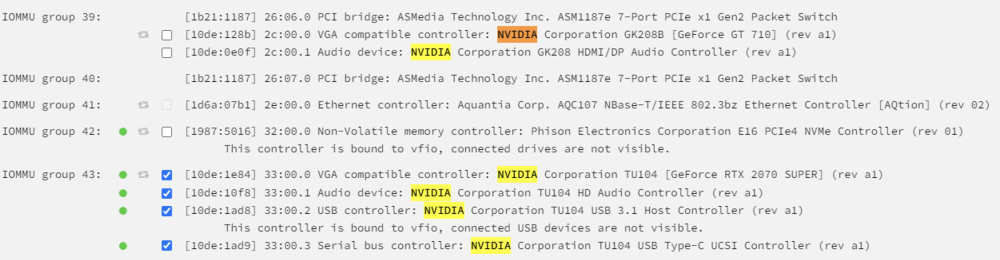

It's bound to vfio-pci, remove this part from /boot/config/vfio-pci.cfg and reboot
0000:33:00.0|10de:1e84 0000:33:00.1|10de:10f8 0000:33:00.2|10de:1ad8 0000:33:00.3|10de:1ad9

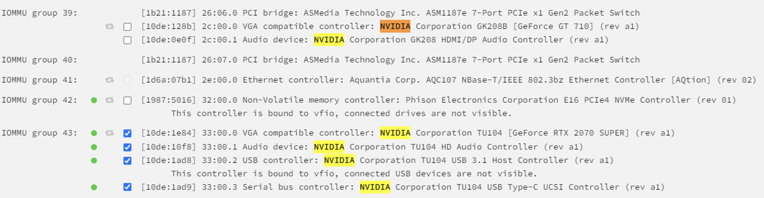

@JorgeB - Apologies, I misspoke. Yes that is my GTX 2070 Super I have for my Windows VM. I do want to pass that through. I have another card that is a crappy little GT710 just for console access which is not passed through. Not sure why my display no longer works with this GT710 and stops at that line. Works fine on 6.11.5.
Edited by johnsanc
I assume the monitor is connected to the other GPU? You could still try to temporarily unbind that GPU just to test.
@JorgeB - Yes the monitor is connected to the crappy GT710 that was not bound. When I removed the RTX2070 from being bound, the GT710 worked and I could see the terminal get to the login prompt. For some reason passing through one graphics card caused the other to stop working. This was not an issue with any prior unraid release.
