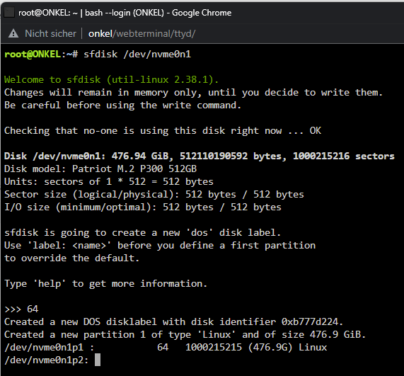

That device has no partition, suggesting it was wiped, we can see if it's recoverable, type
sfdisk /dev/nvme0n1
then type 2048 and hit return and post a screenshot of the results.

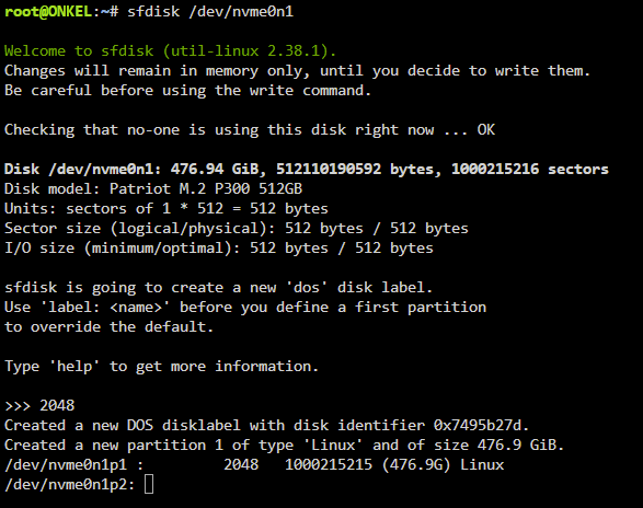

That command by itself doesn't do anything, just trying to see if it can recover the old partition, there's no old partition starting on sector 2048, retry with 64, type:
sfdisk /dev/nvme0n1
then type 64 and hit return and post a screenshot of the results.
You can abort that with CTRL + C, looks like the device was fully wiped, possibly with a full device trim (blkdiscard), so don't see any option to recover the data.

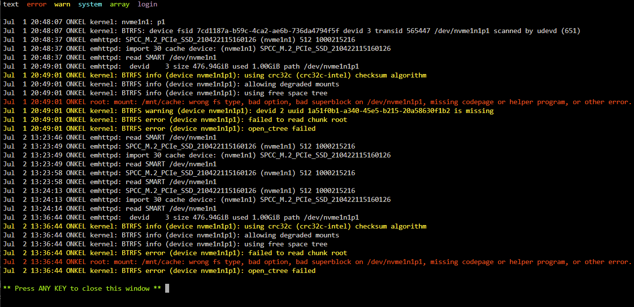

This is the error log from the disk may telling the same we identified already....

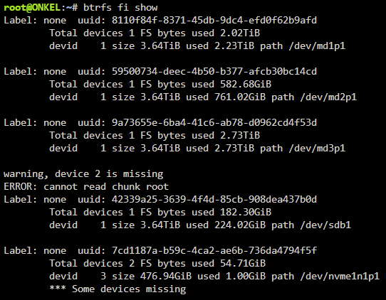

Don't think so but post the output of
btrfs fi show
If you look at the original diags you can see how the pool was configured:
                  Data     Metadata  System
Id Path           single   single    single   Unallocated Total     Slack
 2 /dev/nvme0n1p1 60.00GiB   1.00GiB 32.00MiB   415.91GiB 476.94GiB     -
 3 /dev/nvme1n1p1  1.00GiB         -        -   475.94GiB 476.94GiB     -
   Total          61.00GiB   1.00GiB 32.00MiB   891.85GiB 953.88GiB 0.00B
   Used           54.25GiB 475.09MiB 16.00KiB
Not sure how the pool ended up like this but it's not normal, first note that you have devices 2 and 3, device #1 isn't there, so a device was removed/replaced before, then notice that both data and metadata are single profile, when the user balances a pool to single profile (non redundant) metadata is still raid1 (or DUP depending on the Unraid version), in any case note that the other NVMe device, the one that's empty now (nvme0n1) had almost all the data and all the metadata, the remaining device only has max 1GB of data and no metadata, sorry but don't see any way of recovering data from this pool without the other device.
