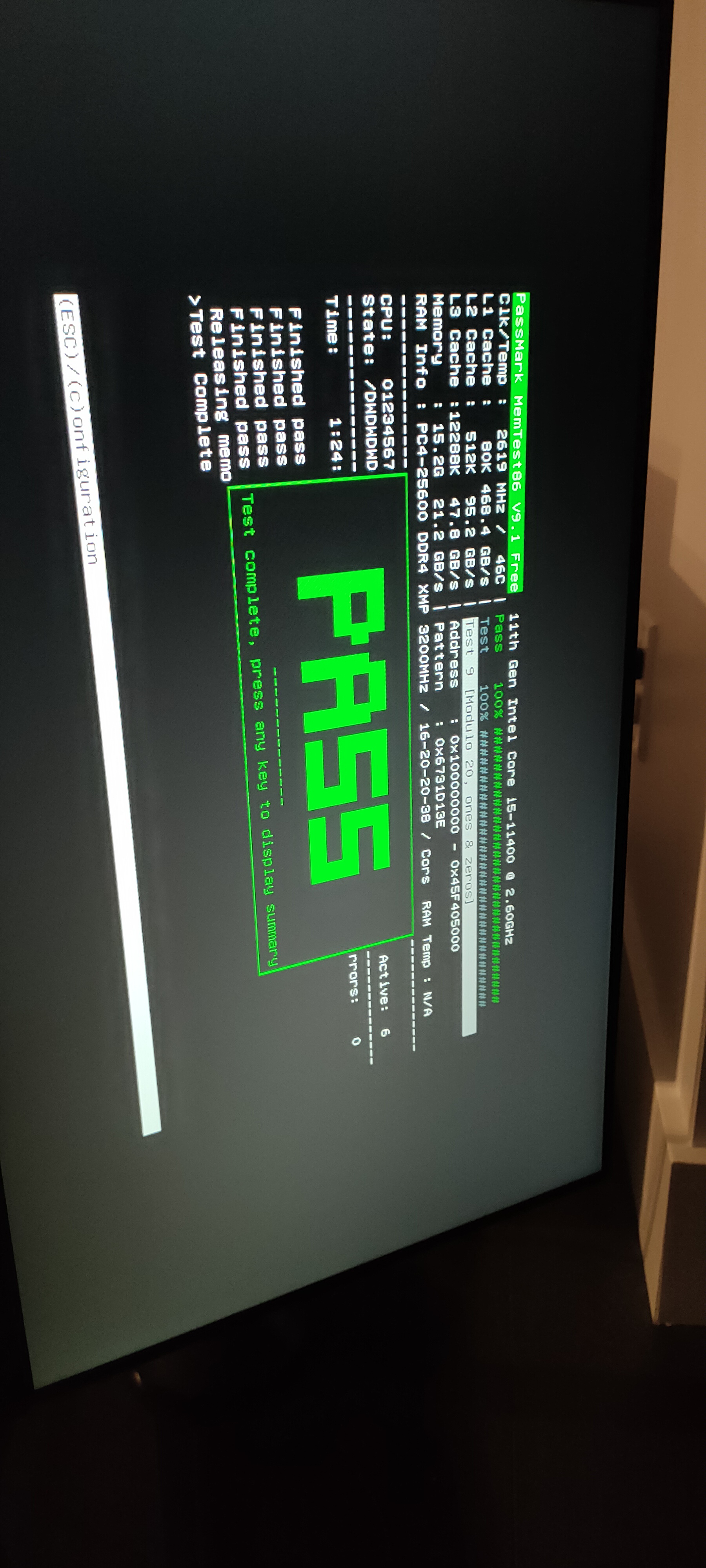

Memtest passed all tests

If you are booting in UEFI mode then the normal recommendation is to download the latest version from memtest86.com which is UEFI compatible (but for licencing reasons cannot be included in the Unraid distribution).  I suspect that is more thorough than will be built into the BIOS of your motherboard.
I'm pretty sure this is the same one; it's integrated into my BIOS - https://rog.asus.com/motherboards/rog-strix/rog-strix-z590-a-gaming-wifi-ii-model/
Edited by AngryPig
Since memtest is only definite when there are errors and you have two sticks of RAM try with just one, if the same try the other one, that will basically rule out RAM issues.
What's the benefit of doing individual sticks if it passed with both of them?
If I wasn't clear I wasn't saying to run memtest individually, but use the server with just one stick and see if you see the same issues.
