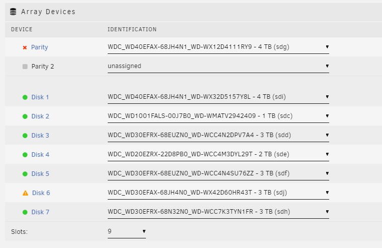

Unfortunately, I'm having the same issue I had a couple of months back, but this time it looks even worse.
You can find the original thread here: https://forums.unraid.net/topic/138169-recover-from-double-drive-issues/#comment-1254907
To sum it up the problem the last time was a drive having issues, (probably cables or the hard drive cage backplane). after trying to rebuild the drive the parity drive also started to throw errors. Luckily everything went well and I recovered all the data.
This time the problem is similar, drive 6 started throwing errors, like last time, and yes, it's the same drive, in the same cage but with a different cable, so I'm starting to think it's the backplane of the cage. This time the drive was also unmountable due to file system corruption. I solved it following the official guide and started the rebuild. Like last time the parity drive started throwing errors during rebuild. Again, same drive, same cage, different cable. And again, this time it's worse than last time, after a reboot the parity is also disabled, so now the array has parity disabled and disk 6 emulated as you can see in the image attached (how? is it possible to have a disabled parity but still use it for drive emulation?)
Unraid gives me the option to start the array and rebuild, but I don't know if it will keep all the data because of the 2 issues. Can I recover from this?

If a disk is invalid (not disabled) Unraid can disable another one, it shouldn't, but it does, you can try to force enable parity and see if disk6 can still be emulated:
-Tools -> New Config -> Retain current configuration: All -> Apply
-Check all assignments and assign any missing disk(s) if needed
-IMPORTANT - Check both "parity is already valid" and "maintenance mode" and start the array (note that the GUI will still show that data on parity disk(s) will be overwritten, this is normal as it doesn't account for the checkbox, but it won't be as long as it's checked)
-Stop array
-Unassign disk6
-Start array (in normal mode now) and post new diags.

Disk6 is and was invalid, not parity.
