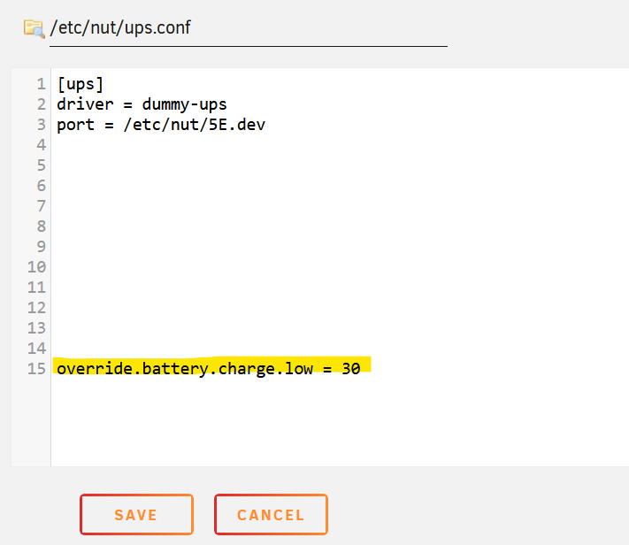

I'm guessing it's because battery.charge.low is set or reported at 100% for some reason.
This'll basically shutdown your system if the battery drops just by 1% (likely to happen during testing).
You can configure this directly on your UPS or UPS software (what charge it considers as "low battery")
If this value is reported wrong from the UPS (say it's set to 30% on your UPS, but NUT still shows 100%)
You can override the value by putting into your ups.conf on line 15: override.battery.charge.low = 30
NUT should correctly report the battery.charge.low value then and act according to this value instead.
But make sure to attempt to set this value on your UPS first - this is something that should be set on UPS.
Only if it's set on UPS correctly and still reported wrong by NUT you should override the value via configuration:

Thanks so much for your reply. I have tried this several times and unraid still shuts down every two weeks.
The Details screen now shows "battery.charge.low=30"
The log file constantly shows:
"Jan 16 07:34:18 Mongo usbhid-ups[4714]: ups_status_set: seems that UPS [ups] is in OL+DISCHRG state now. Is it calibrating or do you perhaps want to set 'onlinedischarge' option? Some UPS models (e.g. CyberPower UT series) emit OL+DISCHRG when offline."
How do I set the "onlinedischarge" option?
