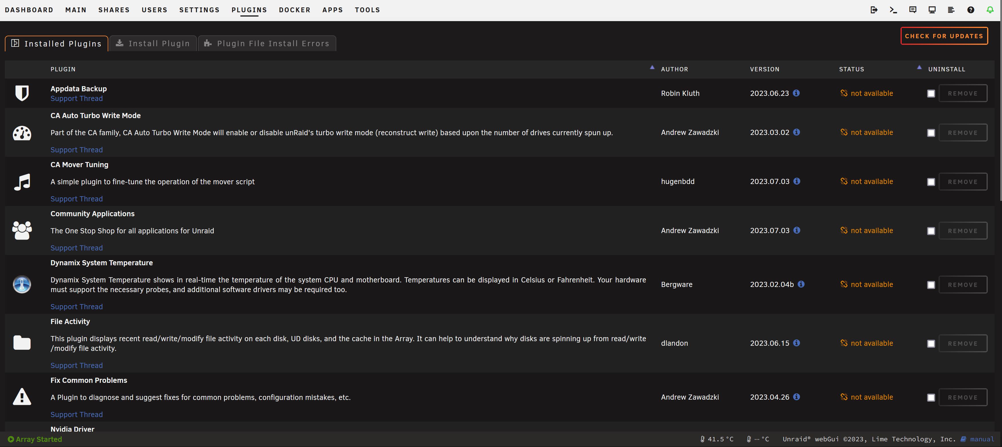

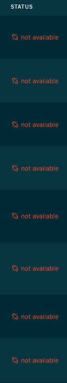

July 2, 20233 yr Hey! So i have an unraid server that's been running fine for the last 3-4 years. Since 6.12.0 and 6.12.1 came, i have some wierd network error that hasen't been before. After 1-2 days of the unraid running, it feels like the OS looses the connection to internet(?) all my dockers etc works and have internet access, but i can't update anything, plugins, dockers and update OS all show not avalible, like the pic below. If i reboot the server, it works again for 1-2 days... Posted my diagnostic, does someone have the same problem and figure out a solution? I haven't changed anything in my firewall or on the unraid, the only change i did was updating the unraid OS. Thanks! Edit - Just found out there was a new release, 6.12.2, i will ty and see if this fixes the issue. Edit2 - 6.12.2 didn't fix anything.. slave-diagnostics-20230702-1339.zip Edited July 4, 20233 yr by DjJoakim

July 5, 20233 yr Community Expert Were you having the issue when the diags were saved? I don't see anything out of the ordinary logged.

July 5, 20233 yr 3 minutes ago, DjJoakim said: Yes, but to be safe - here is a fresh diagnostic from just now. I haven't rebooted unraid since 2-3 days, and the problem has been the last 2 days. Also, when i try to "Check for update" on the plugin page, i get this Checking connectivity ... No response, aborting! slave-diagnostics-20230705-1129.zip 156.17 kB · 0 downloads In your latest log there is a macvlan call trace, change docker settings to use ipvlan instead.

July 5, 20233 yr Solution 1 hour ago, polishprocessors said: Aha, I think I'm having this same issue. When I reboot *everything* on unraid (including unraid itself) loses connection to the internet and my DHCP server reports unraid's IP is no longer live. I've rolled back to 6.11.3 in the meantime to see if there's something that can be changed to fix it, but it seems I'm not the only one having this issue, so hopefully it's straightforward... If using macvlan in docker settings, change it to ipvlan
July 5, 20233 yr Author 1 minute ago, bonienl said: In your latest log there is a macvlan call trace, change docker settings to use ipvlan instead. Alright, i will try it - but does this effect the rest of unraid or only the dockers? Bc it feels like unraid after 1 day just can't connect to internet, if i try to update OS i get "not avalible" if i try to update plugins i also get "not avalible"? Thanks
July 5, 20233 yr macvlan call traces impact the complete system. Your situation is a bit weird. I studied your first diagnostics and everything looks alright. There is nothing in the logs which explains a loss of communication.
July 5, 20233 yr Author 2 hours ago, bonienl said: macvlan call traces impact the complete system. Your situation is a bit weird. I studied your first diagnostics and everything looks alright. There is nothing in the logs which explains a loss of communication. Alright i see, i have now changed it to ipvlan, if it works i will mark this as solution. Thanks for now

July 7, 20233 yr Author On 7/5/2023 at 11:38 AM, bonienl said: If using macvlan in docker settings, change it to ipvlan This fixed it for me, thanks so much
July 7, 20233 yr Author 7 hours ago, djtodd said: I posted a thread about this over a week ago. Crickets chirped. Exact same issue. Networking is fine, Plex is available, but Docker and Plugin checks are "unavailable" Here's the original post with DIagnostics. Updating to 6.12.2 didn't help. tower-diagnostics-20230707-0911.zip 167.16 kB · 0 downloads Have you tried changing docker network type to ipvlan? This fixed the issue for me.
