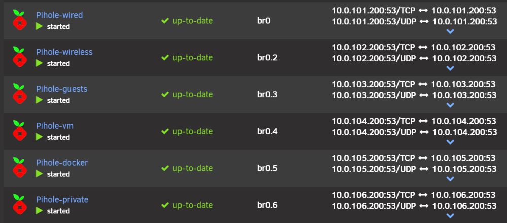

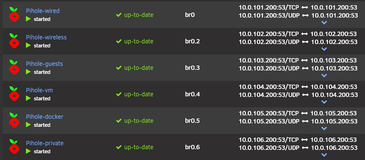

I have 6 DNS servers (PIHOLE) running as docker containers. An other DNS server alternative is ADGUARD. See the apps store.
4 hours ago, bonienl said:
I have 6 DNS servers (PIHOLE) running as docker containers. An other DNS server alternative is ADGUARD. See the apps store....

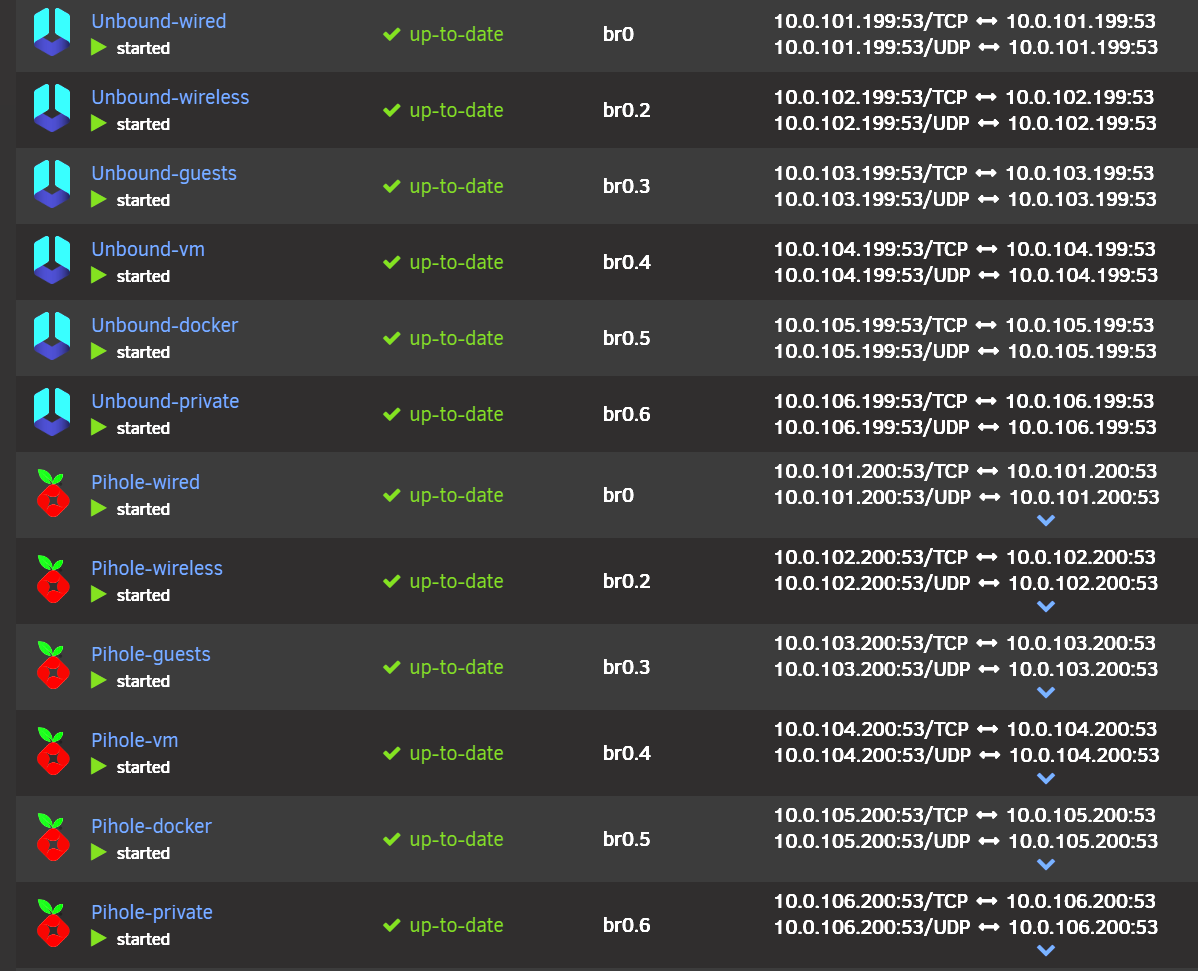

It is possible to run Unbound containers too.
This is what I actually do.

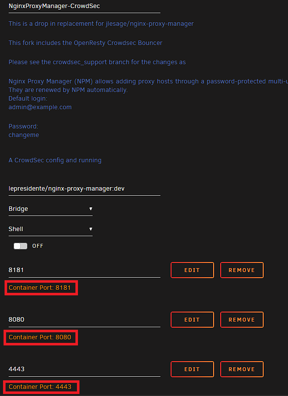

The standard ports of the app are 801, 7818 and 4431. The maintainer of the package even called the variables TCP_PORT_801 and so on, so the only way I see using it is by building your own app, but there is no real documentation on how to do that.
If I'd use host network I couldn't change the ports either, only in bridge I could. But for this I'd have to change the port of the main appliance so I could give NPM port 80.

What another one? The other Crowdsec one has the same issue.
