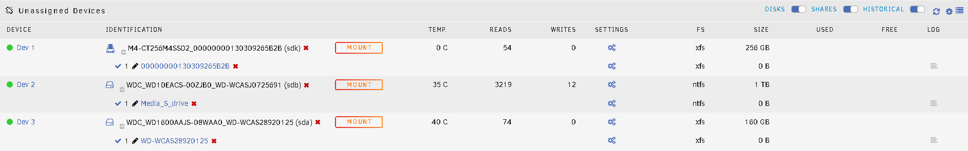

How to add drives to existing pool?
How do I add these drives to an existing pool without "Unmountable: Unsupported or no file system" problem?
Existing Pool "Torrents":
Devices/Drives (sdk, sdb, sda):
I tried adding only the xfs drives together, but ran into the problem of losing my partitions when I start the array.

I wanted to create a new Unraid pool under the "Pool Devices" (not part of the array).
I have a bunch of disks with mixed filesystems.
Pool JBOD, with different filesystems, and the pool/share would look like one big drive.

I think I finally figured it out...you need to use either btrfs or zfs for the actual filesystem pooling.
I added an Unraid Pool.
I used btrfs as the filesystem, as "single" (because I have drives of different size).  This will combine the storage of muliple drives into a single disk/pool.
zfs didn't have the option "single", for different drive sizes.
This was not without quirks...
I needed to format the drives (I had to move the data off the drives I was formatting because I was using xfs).
When I started the Array, the filesystem wasn't recognized, and needed to reformat (but I "erased" in the prior step where I was doing the configuration).
Need to make sure you get the expected pool size.  I didn't the first time, so needed to redo something.  I think this had to do with something Unraid setting the filesystem to auto, even after erasing.  So double check.
Keep in mind that if one of the pool members fail, you will lose the whole pool. There is no redundancy in single profile. The pool members are NOT individually readable like they would be under the main Unraid array.
When I tried creating unraid non-array pools (with different drive sizes), unraid would remove my existing partition.  So I then assume pools have to be zfs or btrfs.
It is confusing me because unraid has something called pools (non-array), but perhaps unraid is just managing a zfs/btrfs pools, not creating it's own.
