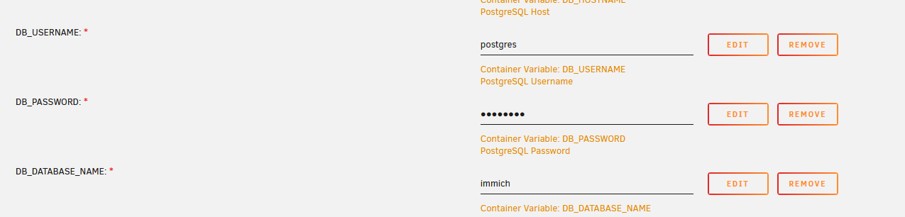

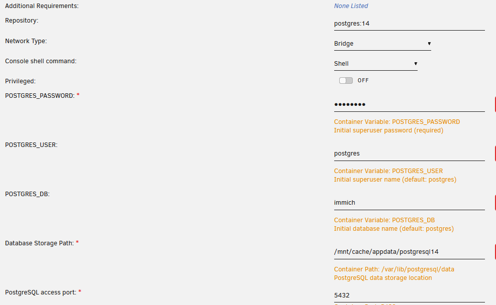

July 21, 20233 yr When setting up Immich following this guide and this guide. I get an error when I start Immich: [Nest] 602 - 07/21/2023, 2:20:12 PM ERROR [TypeOrmModule] Unable to connect to the database. Retrying (6)... error: password authentication failed for user "postgres" at Parser.parseErrorMessage (/app/immich/server/node_modules/pg-protocol/dist/parser.js:287:98) at Parser.handlePacket (/app/immich/server/node_modules/pg-protocol/dist/parser.js:126:29) at Parser.parse (/app/immich/server/node_modules/pg-protocol/dist/parser.js:39:38) at Socket.<anonymous> (/app/immich/server/node_modules/pg-protocol/dist/index.js:11:42) at Socket.emit (node:events:514:28) at addChunk (node:internal/streams/readable:324:12) at readableAddChunk (node:internal/streams/readable:297:9) at Readable.push (node:internal/streams/readable:234:10) at TCP.onStreamRead (node:internal/stream_base_commons:190:23) My Immich setup has this postgres has this: I have verified the passwords are the same. Not sure where the error is. Any help would be greatly appreciated.
July 21, 20233 yr Community Expert Did you run the postgres container before setting the user and password how you wanted them? These are only used on the very first run, changing them later won't do anything. Edited July 21, 20233 yr by Kilrah
July 21, 20233 yr Author Yes, I setup redis and postgres prior to. I have removed all three, set them up in redis->postgres->immich order and still have the issue. I can try again though.
July 21, 20233 yr Community Expert Removing the container doesn't change anything, it's the appdata folder for it you need to remove. Stop container, delete this container's appdata folder, start it again - then you should have what you set in the template.
