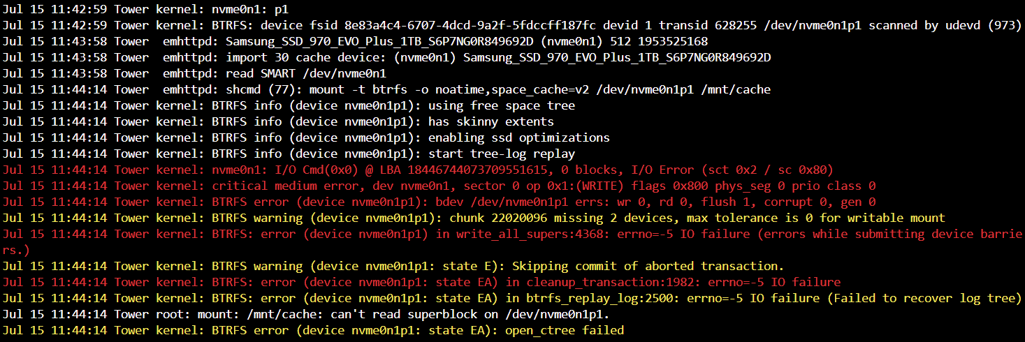

July 27, 20233 yr Hi, I have a failed ssd cache drive that unfortunately had my docker containers on... unintentionally! I am hoping that someone knows of a way to recover the data from the drive so I can transfer it to a new one. The disk log has the following information: Diagnostic file attached the post too. Here's hoping there is a way to recover the data 🤞 tower-diagnostics-20230727-1138.zip

July 31, 20233 yr Community Expert Solution You can try cloning it with ddrescue, success or not will likely depend on how large the failure is.

August 1, 20233 yr Author So I successfully recovered the appdata information and my docker containers reappeared with all information for the Plex installation intact! Lost some media files that were on the cache but that's not so important. Just got to remove the nvme from the cache pool and replace with another drive then shall be where I want to be. Thanks to @JorgeB and @itimpi for the assistance. Much appreciated! 😁🍻 For anyone reading this in the future with the same issue... I used the following thread to install and use ddrescue - https://forums.unraid.net/topic/46802-faq-for-unraid-v6/page/2/#comment-525075 Edited August 1, 20233 yr by ETO Nahlin
