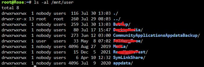

July 31, 20233 yr Community Expert Use the Linux ls command to look at the directory/file structure and names of both files and directories in the vicinity of the missing files. The command would be used the GUI Terminal Window and looks like this ls -al /{path-to-directory} This is the output looking at all of the User Shares on one of my servers: When you get down to the tree to where you have missing files, first verify that you don't have two directories with names like this: Stuff stuff The problem with this situation is that Linux is case sensitive and Windows is not. Thus, Linux will see two directories and Windows will only 'see' the first one it finds. Any files in the second will never be listed(/found) by Windows. EDIT: The shell that is used by the GUI Terminal has a built-in command line editor. <up-arrow> and <down-arrow> will move up and down previously used command. <right-arrow> and <left-arrow> will position the cursor within the command line for editing. This will save a lot of time... Edited July 31, 20233 yr by Frank1940
