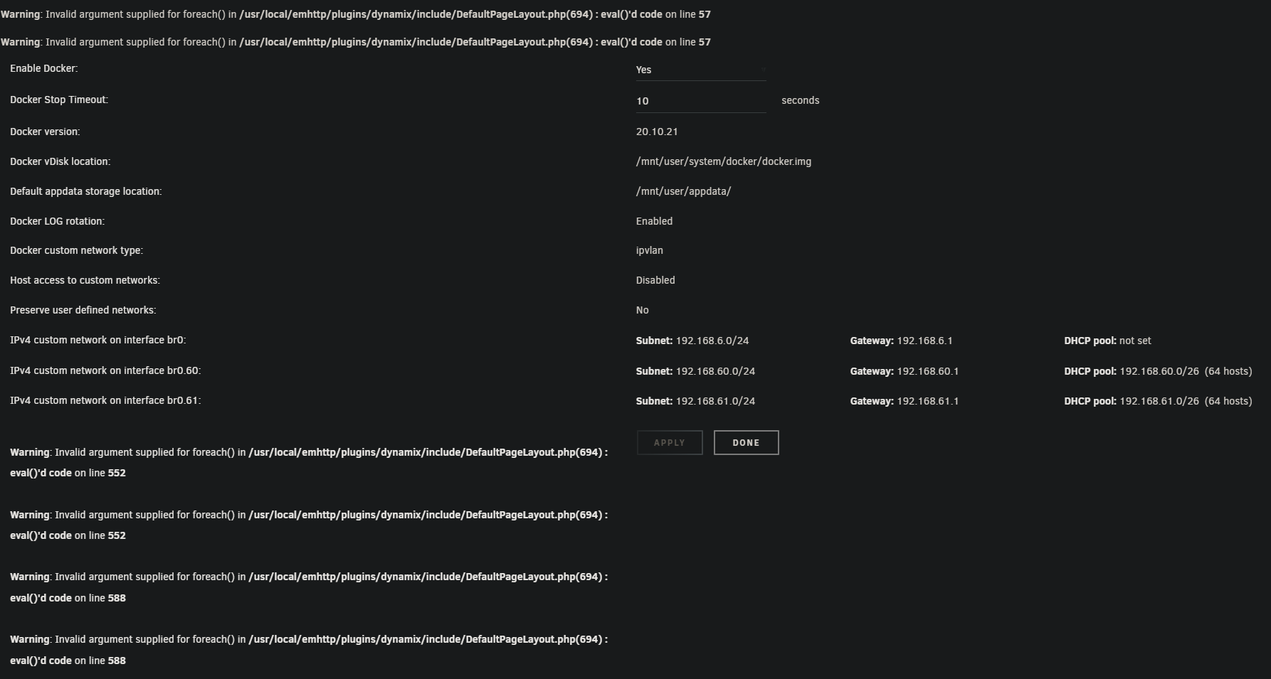

August 8, 20233 yr Hello! Hope someone can help me through this issue I've been having. Can't seem to find the root cause after searching online and through my logs. Background: I recently downgraded from 6.12.x to 6.11.5 due to stability issues, I've been stable on 6.11.5 for quite some time and the recent upgrade to 6.12.x had me crashing at least once a week or so. What I noticed after the downgrade: I followed the official docs on downgrading to an earlier version, and noticed that my docker containers weren't running after a clean reboot. Took a quick peak at the docker settings tab and noticed a number of PHP errors (see below). What I've done thus far: Manual force update for each docker container - this fixed the issue with containers that weren't running Several system reboots (php error still persists) Deleted docker vdisk image, and reinstalled docker containers from templates (php error still persists) Warning: Invalid argument supplied for foreach() in /usr/local/emhttp/plugins/dynamix/include/DefaultPageLayout.php(694) : eval()'d code on line 57 Warning: Invalid argument supplied for foreach() in /usr/local/emhttp/plugins/dynamix/include/DefaultPageLayout.php(694) : eval()'d code on line 57

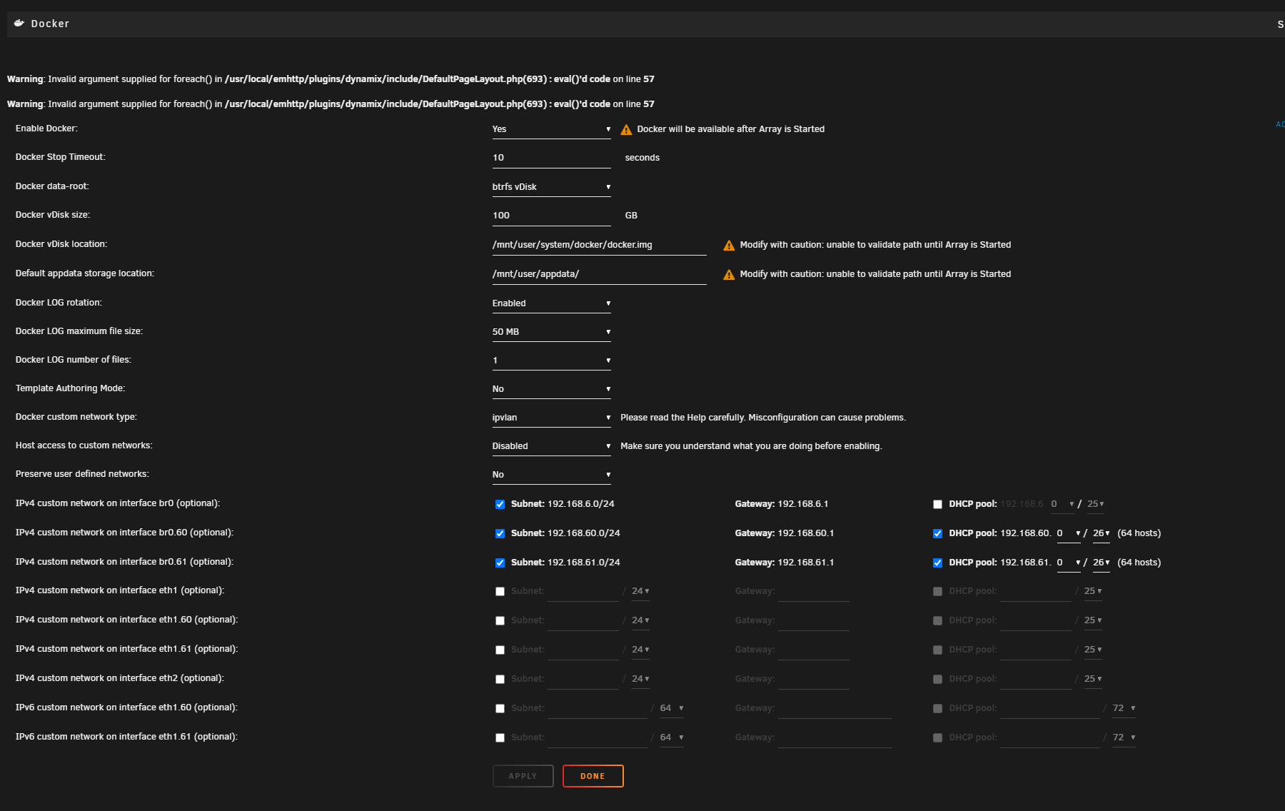

August 9, 20233 yr Author Same errors after rebooting in safe mode (image: Safe mode - array not started), I did however notice that the last set of php errors are not showing up when the array hasn't started. Once started, its exactly like first picture i posted (image: Non-safe mode). Any other ideas? Non-safe mode: Safe mode - array not started:

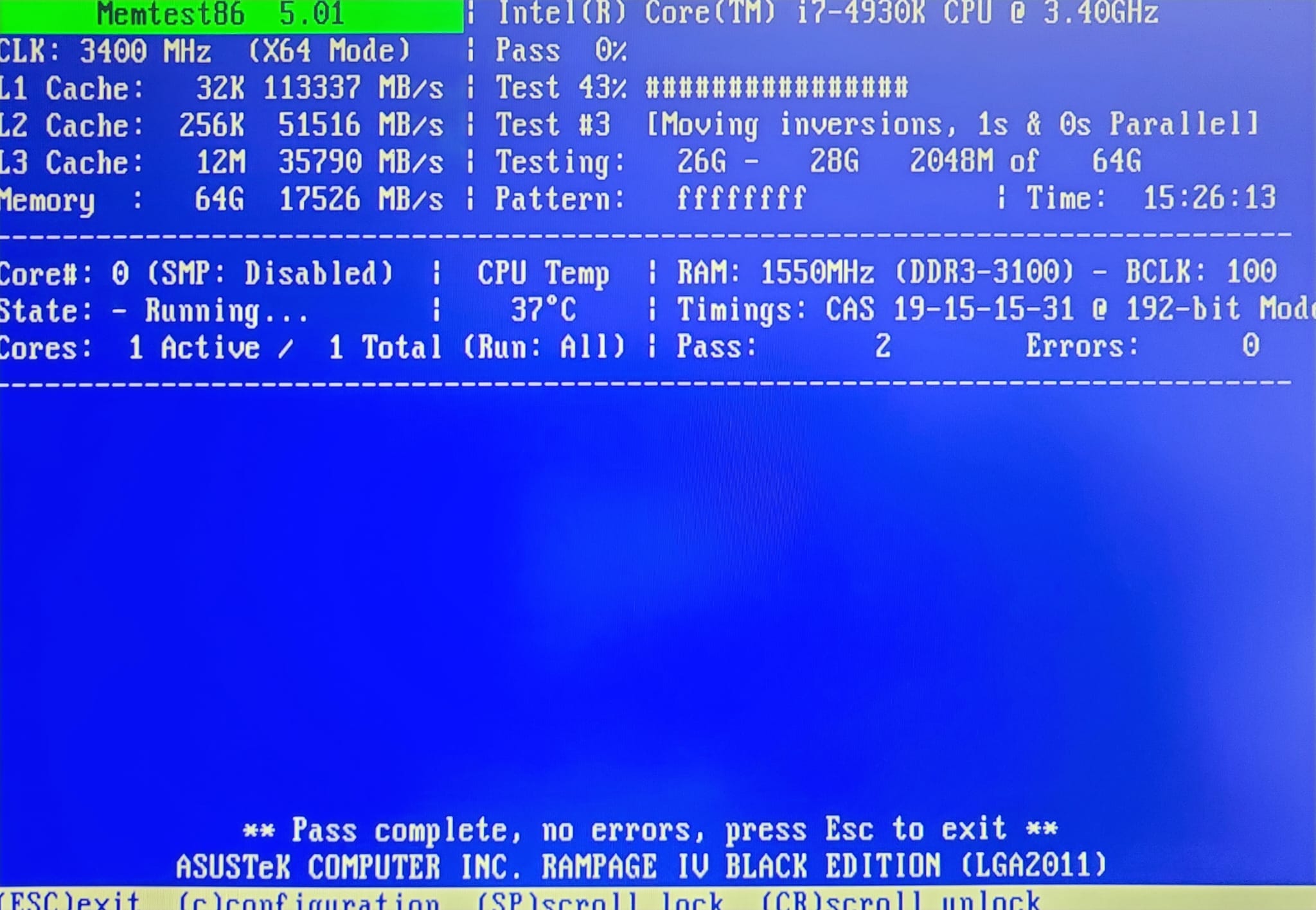

August 11, 20233 yr Author Quick update on the memtest run; no issues with 2 passes. Going to try reflashing the USB stick. Am I basically using the USB Creator tool to install 6.11.5 and copying the config file over? Would that nullify the registration key?

August 12, 20233 yr Community Expert 9 hours ago, VicePrez said: Quick update on the memtest run; no issues with 2 passes. It's usually recommended to complete at least 4 passes. It's not common but sometimes a problematic stick configuration would run fine for a couple of passes but then fail on the 3rd or even 4th pass.
August 13, 20233 yr Author 19 hours ago, Lolight said: It's usually recommended to complete at least 4 passes. It's not common but sometimes a problematic stick configuration would run fine for a couple of passes but then fail on the 3rd or even 4th pass. Yea absolutely, I've seen recommendations anywhere between 2 and 8 passes. I am less inclined to think its memory related; the system has been stable for over 2 years and decided to go kaput after the 6.12.x upgrade. I can do another memtest run next weekend, time permitting. I'm running out of ideas as to what the cause is..
