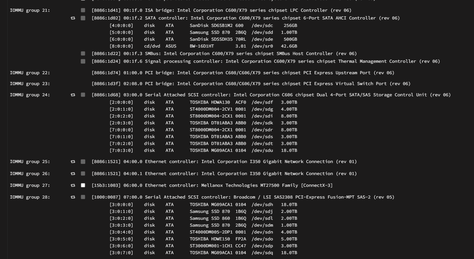

August 20, 20233 yr On 8/19/2023 at 1:38 AM, Compass said: Just had a drive fail so looking to upgrade my 2 6TB parity drives(WDC_WD60EZRZ) with bigger capacity ones, then move the 6TB parity drives into the array which can replace 5 older 2TB drives(formatted as reiserfs, yep they have been running a while). Can get the Toshiba 18TB MG09 for approx AUD$610 Seagate 16TB Exos is the same price, leaning towards the Toshiba Thoughts? Regards Mitch Yes I have 2 x 18Tb for Parity, 1 x 18Tb data, 14TB to be added. Slowly replacing old drives and consolidating.
