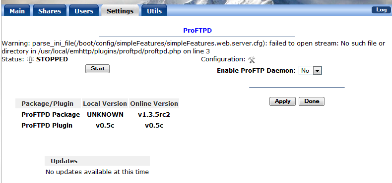

Sorry to reopen an old thread, but just wanted to report that the proftpd installer in unmenu doesn't play well with unRaid 5 rc12a
Per this thread re the plugin version of proftpd, ssl is missing.
http://lime-technology.com/forum/index.php?topic=25695.45
Installing openssl via unraid doesn't fix the problem.
Note the unknown version on the proftpd setup screen.  (this is from the plugin version)

Sorry to say, if installed from a plugin (as you seem to have done to have a GUI screen) then it probably will not have the files expected from an unMENU install.
Joe L.

This shows unmenus proftpd doesn't have a rc.proftpd like my plugin has - it propably doesn't need it. You are trying a command from my plugin with unmenu, which will obviously fail.
If unmenus proftpd install fails, it is not because of this command. You'll have to post a full log or nobody will be able to help you.
Thanks for the correction.  I'll retract this bad info.
