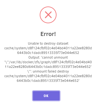

I want to remove a docker container. The GUI just says:image.png.c44c98bb65cb4354b1ca6864ece747f9.png
Now I wanted to remove the container with the cli but the cli returns
root@unRaid:~# docker rm 47244236f0a2
Error response from daemon: container 47244236f0a24da8ce158b796b9e557dd04cba77f922bab3d0a76d4bdd0982c8: driver "zfs" failed to remove root filesystem: exit status 1: "/usr/sbin/zfs fs destroy -r cache/system/d8f124cfbf02c4e04bd4011a22ee8280d6443b0c1dadc89513335f73e044e652" => cannot unmount '/var/lib/docker/zfs/graph/d8f124cfbf02c4e04bd4011a22ee8280d6443b0c1dadc89513335f73e044e652': unmount failed
Ok, then I thought I'd see if I could delete the ZFS dataset. I found it with ZFS Master, clicked on Destroy and this is what happened.
I see the Dataset two times and booth are returning:
What is the problem?

Docker container are removed over the Docker page, not the zfs master plugin. Those snapshots are all created by the dockerservice.
Yeah and the docker page gives me: Execution Error
You would need to post the diagnostics because we can only ask the magic crystal ball for this "execution error".
the zfs plugin/ the snapshots in general are not the way. Snapshots are, well, snapshots not the actual data^^
Edited by Mainfrezzer
After an unwanted power outage, I can now remove the container
