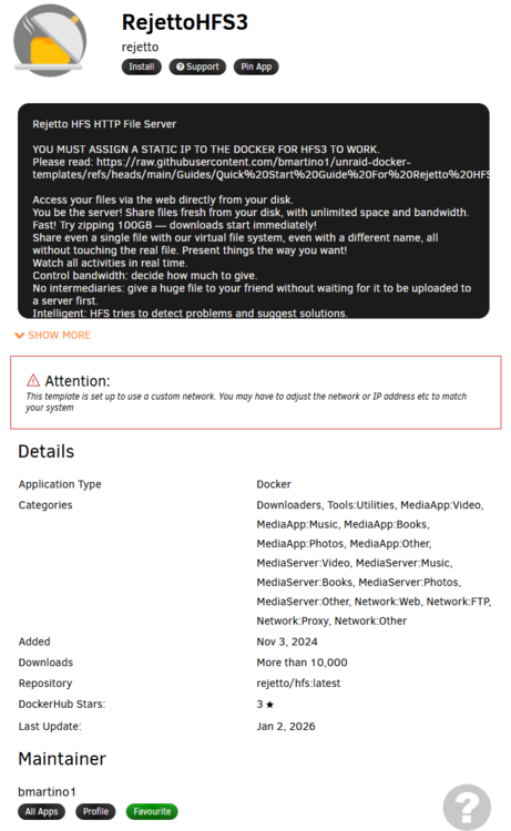

If looking for a server of sorts...
rejeto hfs is also good here http file share some conent web access html5 player in sarfi or vlc app to conect to conntent.
