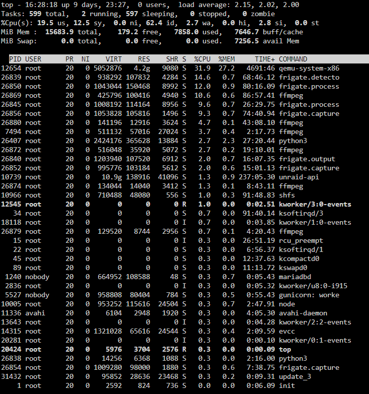

You can open a terminal, run top command to check whether CPU is high. I guessed your cpu is very high.
It's normal usage.

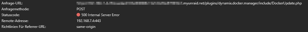

If I check for updates, the DockerUpdate.php fails with a 500 error.image.thumb.png.cba092543092b4810bcbab767d2bda72.png
