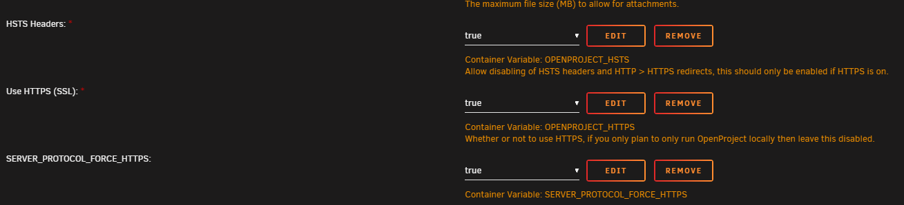

June 10, 20242 yr On 6/9/2024 at 7:10 AM, Ocean HP said: After hours of searching and testing, my solution to the Error 422 was to add the variable: OPENPROJECT_HTTPS and set it to false; both for the value and default value. I couldn't access the login page through my browser (Brave) even after clearing the cache. I was able to access the login page in a private/incognito window. Hope this helps you @Gelantious. Anyone solved the Nginx problem? I've set both the OPENPROJECT_HTTPS, SERVER_PROTOCOL_FORCE_HTTPS, and OPENPROJECT_HSTS to true. Changed the host name to op.mydomain.com. Changed the network to match Swag and got the proxy config file. None of the settings seem to do anything. OP still listens on the localhost:port. Maybe there is another variable we have to use? Thank you kindly, the OPENPROJECT_HTTPS variable worked great for me
