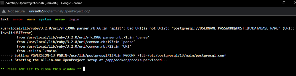

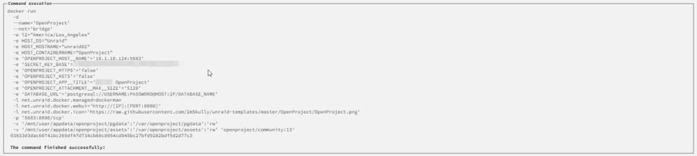

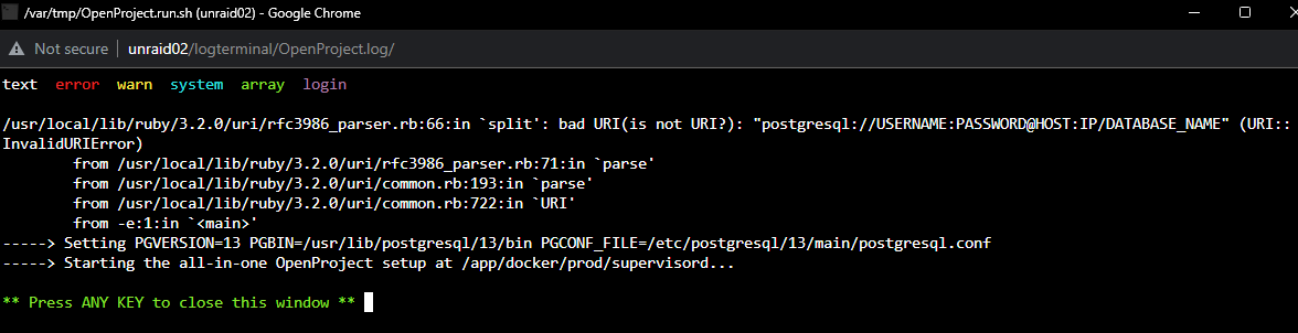

September 20, 20233 yr Hello! Trying to get this installed and running into the same error on multiple Unraid boxes - read through the instructions and feel like I've covered all bases... but we all know how that goes, guessing I'm missing something obvious. Only things I updated when installing in the template was changing the hostname to the IP (10.1.10.124:5683) and added a super secret key for signature - then hit apply. Each time coming up with a Postgres issue, looks like it's using the variable names and not the actual variable data if that makes sense. (ie shows 'DATABASE_URL' = ' postgresql://USERNAME:PASSWORD@HOST:IP/DATABASE_NAME ' for the command, and not the actual values.) As soon as the container is started after initial install, it immediately shuts down and will not startup. (didn't even boot up for the initial few minute delay for DB/container to populate) Below is what I'm seeing in the error log. Attempts to start it after that initial setup all fail with the same error. **UPDATE** Was able to get this resolved... was indeed something silly, didn't see the DATABASE_URL variable in the template... turns out I was missing the "Show more settings" at the bottom - heading here and removing the string for the DB made it work! Happy to remove this post - figured might be helpful for anyone in the future pulling a "me", haha. Edited September 20, 20233 yr by SpuriousIndices fixed - updating post

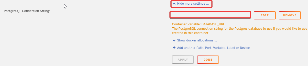

September 20, 20233 yr Author @SpuriousIndices Glad you got it it resolved and thanks for sharing - sorry about the DATABASE_URL variable, it seems that OpenProject is not checking to see if the variable value is blank so it will always attempts to use it instead of creating its own Postgres database. I have removed the variable from the template, if anyone is looking to use an existing Postgres database please see 'Using an Existing Postgres Database' in the first post. Edited September 21, 20233 yr by ImSkully
September 21, 20233 yr I actually had to remove the "DATABASE_URL" label to get it to run. Leaving it blank, resulting in errors trying to connect to an undefined remote postgres server.
September 21, 20233 yr Author 17 hours ago, irishjd said: I actually had to remove the "DATABASE_URL" label to get it to run. Leaving it blank, resulting in errors trying to connect to an undefined remote postgres server. Yeah I've discovered this too (see my last comment) and have removed the variable entirely from the template. It's annoying that OpenProject aren't validating env variables to check they have a value first before using them 🙄 I'll either open a feature request for Unraid to add the ability to make template variables not be added to the container unless they have a value, or open a bug report with OpenProject to validate this variable before using it. Update: Opened a bug report on this and it has since been fixed with OpenProject and will be made available in the next patch release. Edited September 22, 20233 yr by ImSkully

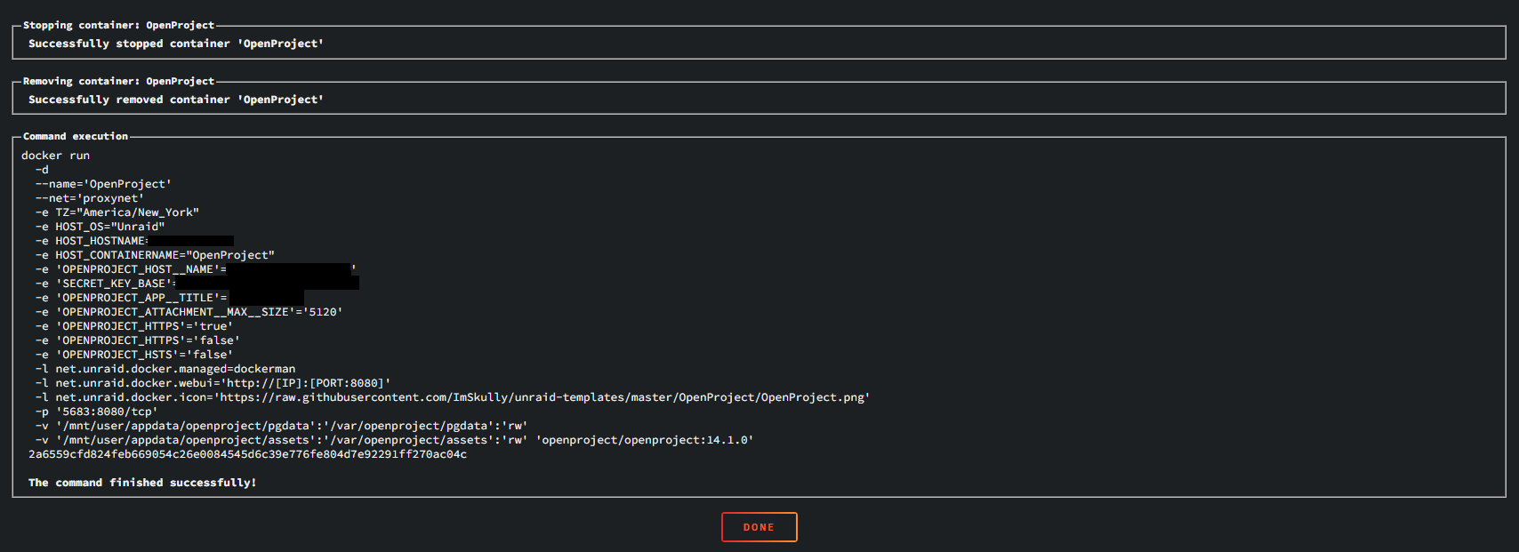

November 19, 20233 yr trying to resolve the 'HTTPS mode setup mismatch' error adding the environment variable does not does not solve the mismatch. OPENPROJECT_HTTPS=true Anyone get this to work with cloudflare tunnel?
November 19, 20233 yr Author 14 hours ago, Tolete said: trying to resolve the 'HTTPS mode setup mismatch' error adding the environment variable does not does not solve the mismatch. OPENPROJECT_HTTPS=true Anyone get this to work with cloudflare tunnel? I haven't used OpenProject via tunnel or proxy so I can't be of much help, though I know you may also have to set SERVER_PROTOCOL_FORCE_HTTPS=true for it to work. Edited November 19, 20233 yr by ImSkully
November 21, 20233 yr On 11/19/2023 at 12:09 PM, ImSkully said: I haven't used OpenProject via tunnel or proxy so I can't be of much help, though I know you may also have to set SERVER_PROTOCOL_FORCE_HTTPS=true for it to work. I have both variable set on the container. OPENPROJECT_HTTPS=true SERVER_PROTOCOL_FORCE_HTTPS=true still no joy, shows the 'HTTPS mode setup mismatch' error after logging in. Edited November 21, 20233 yr by Tolete

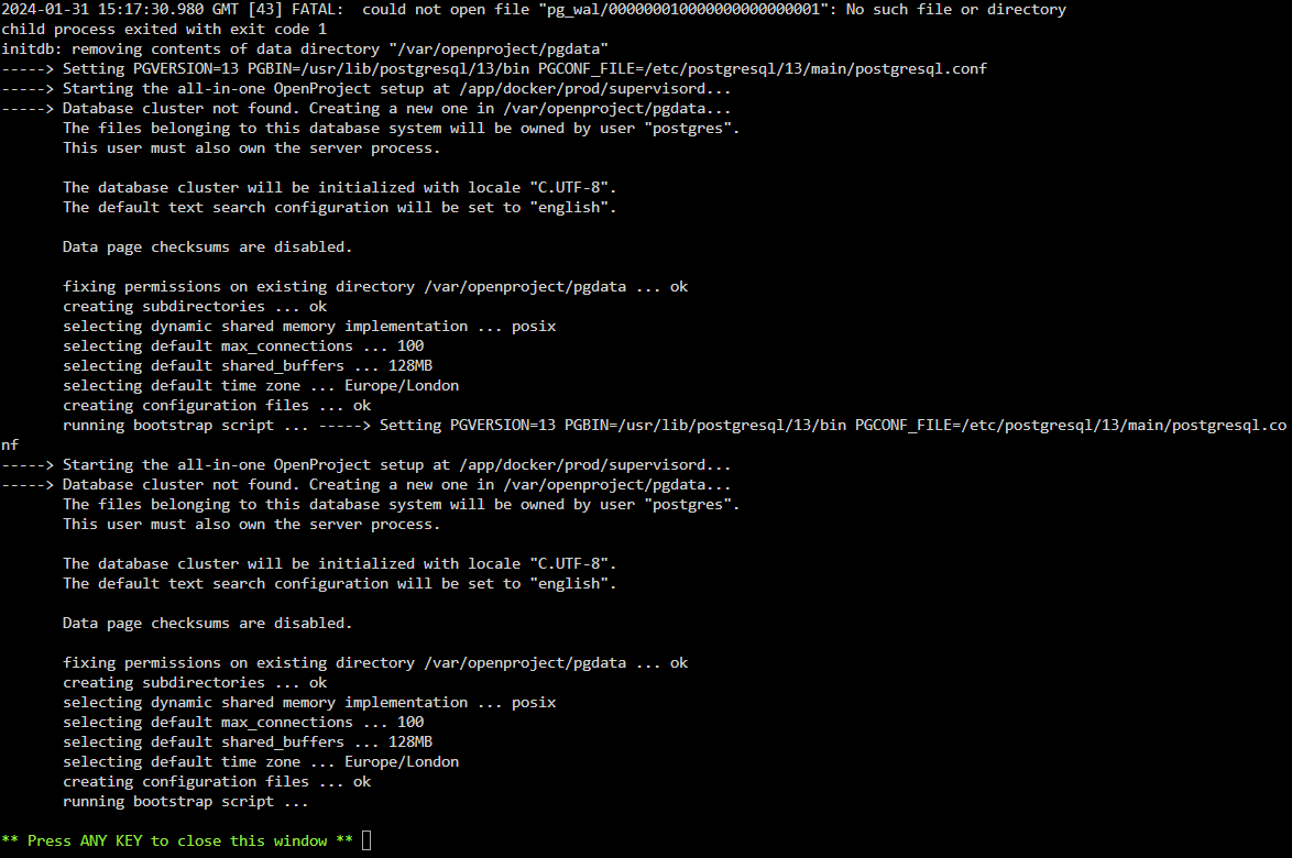

January 31, 20242 yr Hi, I've tried installing this, only thing I've changed is the hostname (to the server IP) and the key, but as soon as the container gets to "running bootstrap script ...", it quits. Never gets any further. Any thoughts?
January 31, 20242 yr Author 30 minutes ago, jokeruk2 said: Hi, I've tried installing this, only thing I've changed is the hostname (to the server IP) and the key, but as soon as the container gets to "running bootstrap script ...", it quits. Never gets any further. Any thoughts? Hey, I have just tested by creating a new container using this template and adjusting just the server IP and key as you mentioned - the container started correctly and created the PG database & migrations. Are you able to provide the full logs? Looking at the screenshot you provided my best guess is that it's something related to the appdata directory it's trying to use (by default is /mnt/user/appdata/openproject/pgdata) which is where it stores the postgres data. Is the directory being created? does the container have permission to it? Are you running low on disk space perhaps?
February 2, 20242 yr On 1/31/2024 at 4:04 PM, ImSkully said: Hey, I have just tested by creating a new container using this template and adjusting just the server IP and key as you mentioned - the container started correctly and created the PG database & migrations. Are you able to provide the full logs? Looking at the screenshot you provided my best guess is that it's something related to the appdata directory it's trying to use (by default is /mnt/user/appdata/openproject/pgdata) which is where it stores the postgres data. Is the directory being created? does the container have permission to it? Are you running low on disk space perhaps? It's creating the directories, but you might have a point with permissions - I'll check.

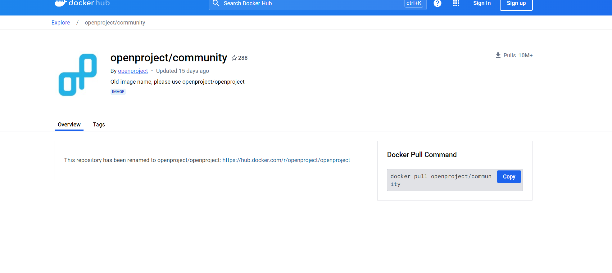

May 22, 20242 yr Hi, i have a question, can you update your repository? Because OpenProject changed their docker hub link to openproject/openproject so its not openproject/community anymore. Thank you in advance :)
May 24, 20242 yr Author On 5/22/2024 at 2:26 PM, Dragonhunt said: Hi, i have a question, can you update your repository? Because OpenProject changed their docker hub link to openproject/openproject so its not openproject/community anymore. Thank you in advance Sorry for the delay! The docker registry has been moved to openproject/openproject and updated to the latest recommended stable release version 14.1.0. On 4/25/2024 at 8:54 PM, TheCyberQuake said: Having the same issue. Many terrabytes of free space, perms look to be in order, but I'm not sure on specifics of what the perms should look like. assets folder is owned by my username, pgdata folder is owned by 103:106. pgdata folder gets created but it's completely empty. Error I get is identical, failing at boostrap script: Please try update to the latest version and see if the still issue persists. Edited May 24, 20242 yr by ImSkully

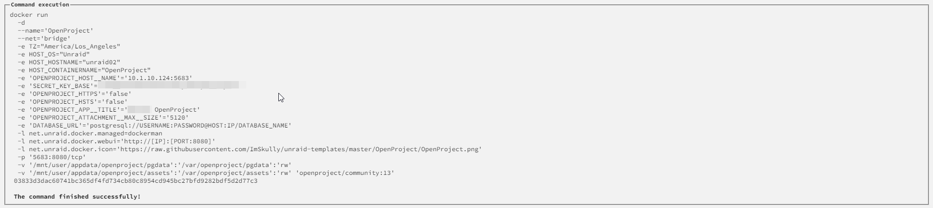

May 28, 20242 yr On 9/14/2023 at 4:44 PM, ImSkully said: Common Issues Login Credentials Not Working If the default username and password of 'admin' are not working on a fresh install, you have likely previously installed OpenProject and have your old Postgres database data still in your configured Postgres Data Directory (by default this is /mnt/user/appdata/openproject/pgdata) To fix this, delete the contents of this directory with the container stopped and then start it up again - this should recreate a fresh database for you to use with the default credentials. SSL/HTTPS Error on WebUI (ERR_SSL_PROTOCOL_ERROR) If you enabled the OPENPROJECT_HTTPS setting and started the container, you are expected to additionally configure your OpenProject instance such as the hostname and supporting for running behind a reverse proxy if you are using one; refer to the official documentation on how to do this correctly. Alternatively if you do not have HTTPS enabled and still see this error, it is likely you have a cached DNS entry which is pointing your current hostname to HTTPS. To resolve this you can simply clear your DNS and wait, or change the WebUI port to something else and restart the container. Updating from v13.0 to v14.1.0 See comment below for more information. It seems the container is always appending 'OPENPROJECT_HTTPS' = 'false' to it so it overrides when we set it to true as a variable, I'm not sure how to workaround that within unraid other than to build my own docker compose until this one is fixed.
May 30, 20242 yr Author On 5/28/2024 at 5:11 PM, CypherColt said: It seems the container is always appending 'OPENPROJECT_HTTPS' = 'false' to it so it overrides when we set it to true as a variable, I'm not sure how to workaround that within unraid other than to build my own docker compose until this one is fixed. Thanks for reporting, it seems OpenProject are just checking for the presence of the variable regardless of its value. Edited June 9, 20242 yr by ImSkully
June 3, 20242 yr Hello, just install this but getting stuck on the login, getting an 422 error. Quote [Error 422] Unable to verify Cross-Site Request Forgery token. Did you try to submit data on multiple browsers or tabs? Please close all tabs and try again. The OpenProject cookie is missing. Please ensure that cookies are enabled, as this application will not properly function without. I've tried clearing cache, other browsers and another computer all together, still no luck...
June 9, 20242 yr On 6/3/2024 at 4:19 AM, Gelantious said: Hello, just install this but getting stuck on the login, getting an 422 error. I've tried clearing cache, other browsers and another computer all together, still no luck... After hours of searching and testing, my solution to the Error 422 was to add the variable: OPENPROJECT_HTTPS and set it to false; both for the value and default value. I couldn't access the login page through my browser (Brave) even after clearing the cache. I was able to access the login page in a private/incognito window. Hope this helps you @Gelantious. Anyone solved the Nginx problem? I've set both the OPENPROJECT_HTTPS, SERVER_PROTOCOL_FORCE_HTTPS, and OPENPROJECT_HSTS to true. Changed the host name to op.mydomain.com. Changed the network to match Swag and got the proxy config file. None of the settings seem to do anything. OP still listens on the localhost:port. Maybe there is another variable we have to use? Edited June 9, 20242 yr by Ocean HP
