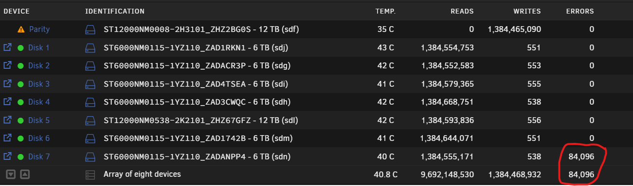

Ok I just put in the new card hooked it all up and started up the server checked, repair the filesystem for each drive and made a new config. Parity is running but it says its going to take 73 days. in the process of writing this one  of the disks is showing errors during the parity sync. Am I missing something? how do I fix the error is the drives are good? or are they bad?

ATA errors on disk9, looks like power/connection problem, that one is connected to the onboard SATA, replace cables and try again.

Disk7 mounted after the new config, bu then there were a lot of read errors, they look more like a power/connection issue, replace cables and try again.
