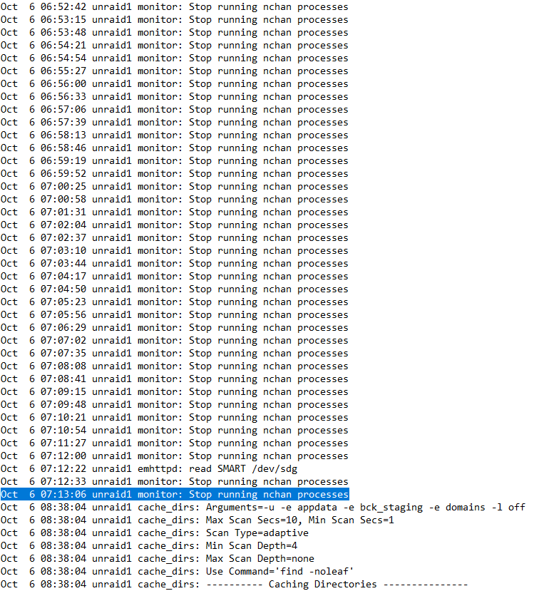

here is the part of the syslog where the server started misbehaving ( no Homeassistant yesterday 14th when I wake up) and a few random entries during the day unitl I came back and rebooted at 20:09 today (15th)
There was no dockers running/accessible (HA, homepage, z2m etc)
No SSH, no unraid webinterface -

Oct  6 08:38:04
Oct 12 12:11:14
Oct 15 20:09:49
are there other settings for syslog or other tools I should enable to assist in the troubleshooting ??
(have adjusted syslog to 1mb files and to keep 4 files from now on)
syslog-192.168.2.141_3.log
Unfortunately there's nothing relevant logged, this usually points to a hardware issue, one thing you can try is to boot the server in safe mode with all docker/VMs disabled, let it run as a basic NAS for a few days, if it still crashes it's likely a hardware problem, if it doesn't start turning on the other services one by one.

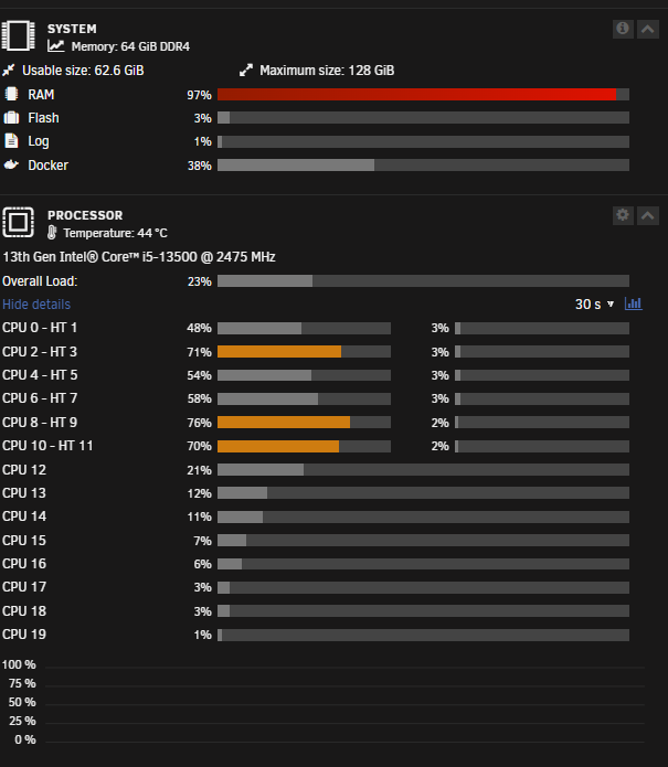

then after  a copule of hours it froze again,, this time with the gui open on my laptop
1333381337_2023-10-2117_49_54-unraid1_Dashboard.png.50a9efe1bf3c166a2ec1754cddfed0ad.png
it seems like something is eating my RAM,,, how can I test what it is??

Close all Vms & dockers.
Run 1 at a time until you find the issue.
Also on docker tab choose advanced so you can see the cpu & ram usage.
otherwise it could be a psu or hardware issue.
My high ram usage is zfs arc. not sure what yours is.
FWIW, I was having issues with freezes on 6.11.5 with ssh and console logins working but getting stuck immediately (never getting a shell prompt). The only way to "fix" was to do a hard reboot since any file I/O got stuck.
I'm now fairly sure this was caused by a combination of a Docker container performing relatively intensive I/O (duplicacy) and mover running at the same time. My guess is that this triggers a bug in shfs which causes it to hang, basically blocking all filesystem I/O (which explains why I could still log in, since credentials are likely cached in RAM, but then getting stuck).
I rescheduled mover to run once a week (it was running daily, which isn't really necessary in my setup anyway) and made sure that it doesn't overlap with any I/O heavy Docker tasks, like running backups. So far, my server has been up 71 days, whereas before I was happy to have it last more than 2 weeks.

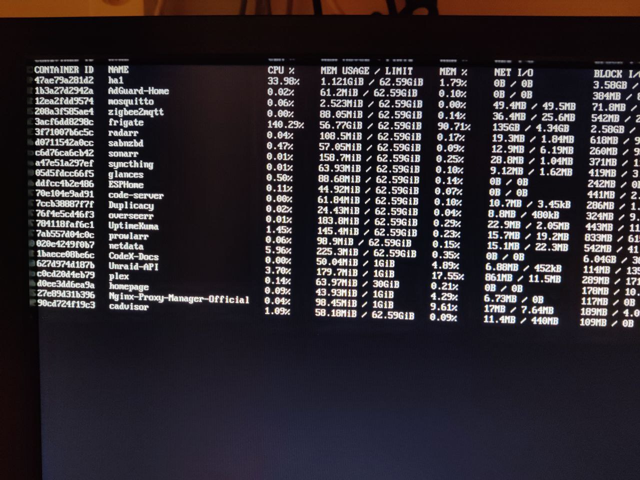

new server-freeze,,, restarted at Oct 26 23:15:58,,
Same status,, no ssh, no terminal-login,, but this time I actually had "docker stats" running ,, and it was showing some hefty ram-usage for Frigate !!
so rebooted server and set a cap on Frigate (ExtraParameter; --memory=10G )
Attaching syslog if anyone would be so kind to see if there is some useful info - now that we (at least I) suspect Frigate as the ram-hog that is freezing/crashing the server,,,
