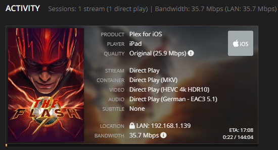

I have a very similar setup like you, i5-10400 CPU, but 62GB RAM an d 1Gbit Network. The CPU is more than capable to stream "Direct Play". I can even play 4K on my iPad via WiFi.
EDIT: The movies are stored on 6TB WD Red Plus and 18 TB Thosiba HDDs.

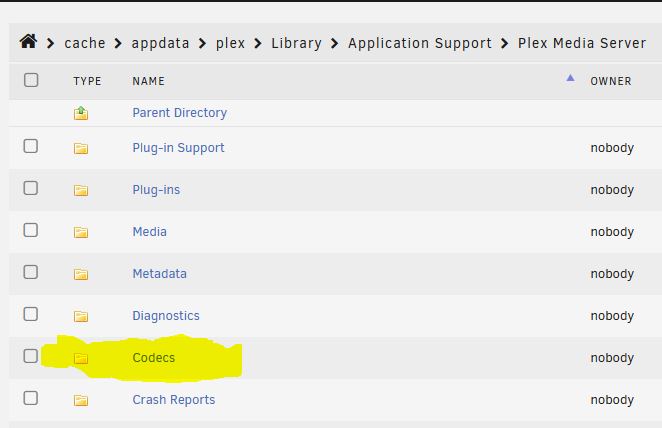

A shot in the dark, but one I've recommended and has solved many peoples' issues - Delete the Plex codec folder from your appdata.  Sometimes a corrupted codec can cause issues.  Restart Plex, and it will download a fresh set of codec.
