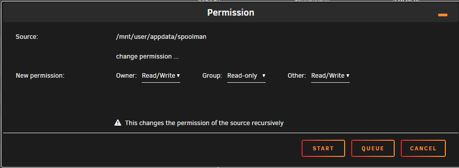

Hi, i trying to resolve the permission issues on Spoolman github, but nothing so far. The workaround is manually changing permissions for the appdata folder created (i dont know why its created with wrong permissions). You can use the original path to the container data folder "/home/app/.local/share/spoolman" and manually change appdata folder permissions to this
or run the new permissions tool from "Tools" tab in the unraid menu.

Hi, mount appdata to the original path "/home/app/.local/share/spoolman", start the container and if it shows permission error in the log run New Permissions from the "Tools" menu in unraid. That should fix it and database should be in the right place in appdata
