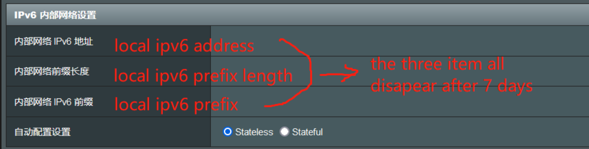

thank you for your replay
"cannot get normally" means can not get ONE public address like 2001:470:....
and i think you are right the main problem is the  settings of my router, it may does not pass the "router advertisement protocol" rightly, i will try to grab the packet to check it exist or not.
and also, you are right "May it be that you have a castrated ISP connection which uses NAT on V6" , the three items below all disappear after 7 days😂
This can be normal, depending on the DHCP settings. But IPV6 usually does not use DHCP at all, usually it only announces the prefix through the router and the clients themselfs pick their addresses. This is called SLAAC (stateless adress autoconfiguration), but if your router sends the wrong packet, clients may switch to stateful address assignment (the router only annouces a default route, the client asks again, looking for a local DHCPV6 Server to give him an address).
The stateful mode is rare and DHCPV6 servers are really uncommon to non-existent.
So I guess your router is wrongly sending the "stateful" bit. instead it should send the "stateless" one.
