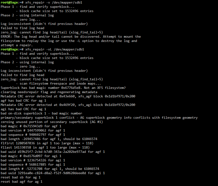

So I did xfs_repair -v /dev/mapper/sdb1 and received a short error. Then I ran xfs_repair -vL /dev/mapper/sdb1 and got some results that I don't understand. Should I post a new diagnostics? Not sure if this would be included.
Instead of a screenshot copy/paste the full xfs_repair output here.
