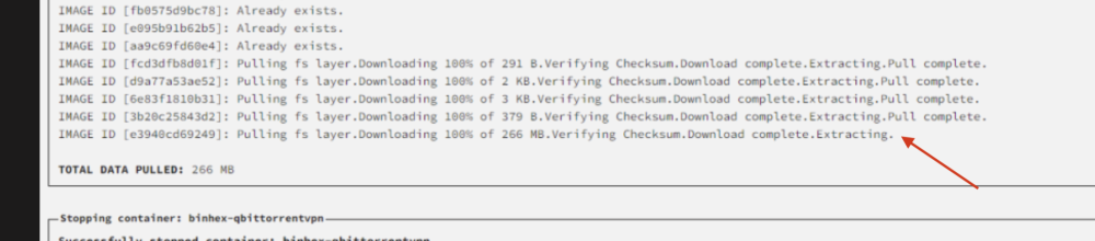

  • I didn't follow the whole thread but I found a solution for my problem. Essentially like others, I would click to update my container and the pull/extract process of the docker image would timeout. Ho

I didn't follow the whole thread but I found a solution for my problem. Essentially like others, I would click to update my container and the pull/extract process of the docker image would timeout. Hopefully this helps out someone having similar issues. How I fixed this...
1. Open Unraid terminal as the 'root' user.
2. Run the following commands...
    a. I like to verify the image is in my local repository. It's also easier to copy/paste the repository name
docker image ls
    b. Manually update the container, replace with the actual repository name from above
docker pull repository_name
    Note: Because my image was pretty big (2 GB at this point), it took 5+ minutes for it to update in the terminal
3. Go back to Unraid GUI > Docker > Click to update container
4. Update should be quick, because we already pulled/updated the image to the latest version
5. Now says "up to date". Profit

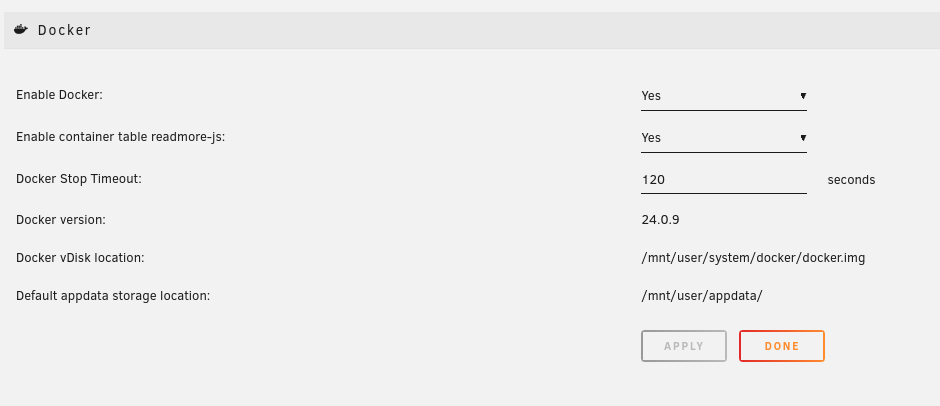

So in theory setting the Docker Stop Timeout should also work perhaps (but also not ideal as that can cause issues during shutdowns). I had mine set to 360 seconds, but it still wasn't enough for home assistant to update.
I guess I'll put the terminal commands into a user script and kick that off before the next update for now. It's too bad the system isn't smart enough to be a bit more generous with the time allowances during an update...

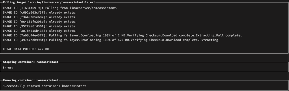

I just started running into this in the past few weeks. Certain docker updates that include pulls of >200MB for a section fail. I also could not complete the download of the 7.2.2 update as it also repeatedly failed during the download. The percent completed on the download varies somewhat - never at the same point. I had to do a manual update for the 7.2.2 and manual pulls for the dockers that have larger file segments. Even then the docker pull command struggles.
I can't help thinking that this is not an issue with my network and/or server? Everything else runs fine and have no issue with file transmission and my server is connected through 10GPS SFP+ to my router.
Of course I am open to suggestions as there may be something configured incorrectly here. But why did it just start doing this?

Just out of curiosity I went to another machine on my network running docker. I ran the docker pull on this (Windows PC) and it worked each time. It is in the rack next to my unraid server. This seems to point to having an issue running these commands on unraid only but not sure if that proves anything?
This is now a repeating issue for me. Ollama and Immich both have large files in them and my server fails downloading them with every update.
I too have started to use "docker pull repository_name" for Immich and frigate (Thanks tacojutsu). Looking at the forums and reddit, this seems this has been an ongoing problem in verson 6 and 7, that has never been truly solved. People try changing DNS, change the docker timeout, move the docker image from cache to array, or array to cache, and then it works sometimes, I don't think any of those solutions, are solutions, and they just appear to work, randomly, but not repeatable because of the several times the user re-runs update. I too think it has something to do with dockers that have large files that have to be downloaded.
Looking at all the different threads, there is no true fix...
Please fix..

For the last months (years?) I tried all possibilities known to me, to solve this problem. Nothing helped.
So I took another round on this today and tried to keep my brain turned on while doing so.
As the most promising way mentioned in this thread was the "docker stop timeout" way, I was wondering why this was initially set to 20 (at least on my system - others had 10 - perhaps I set it to this value myself in the past).
I thought what might happen when I set it even higher. Lo and behold, after setting it to 600 (10 minutes) my home bridge and music-assistant dockers - which before permanently refused to complete the extraction phase - updated till the end!!
So, perhaps this timeout not only controls the timeout when STOPPING a container, but also when UPDATING it.
I now have set it to 900, just to be sure...
UPDATE:
The success above seems to have been by chance...
Just ran an update session containing NextCloud AIO, MySQL and HomeBridge. Results:
NextCloud: 18 files, 94MB pulled, largest file 25MB - SUCCESS
MySQL: 10 files, 261MB pulled, largest file 155MB - FAILURE on the 2nd last file, the largest one...
HomeBridge: 8 files, 371MB pulled, largest file 254MB - SUCCESS (the 254MB file was the first in the list, so had been extracted first)
So I am as wise as before... At least, it worked for 66% of the update 😎
I have no idea why it seems to be so hard to find the correct timer resp. timeout setting to end this mess.
