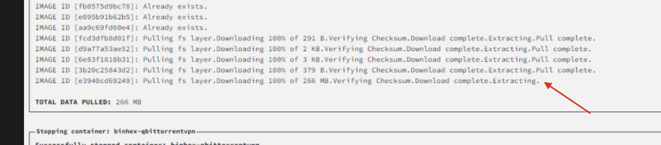

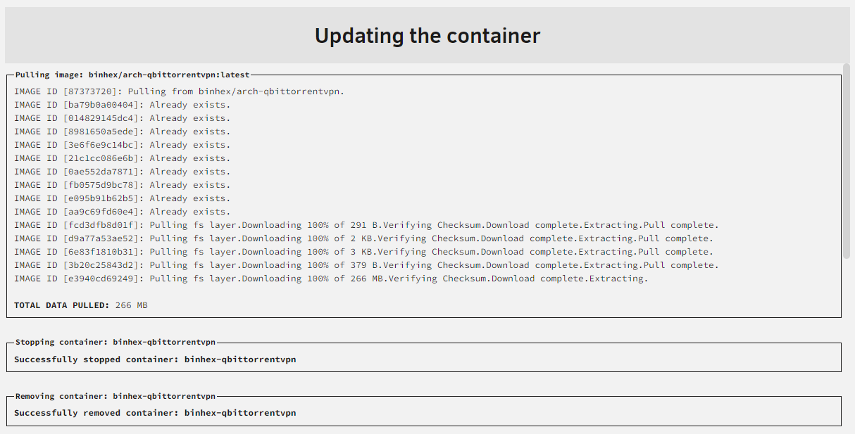

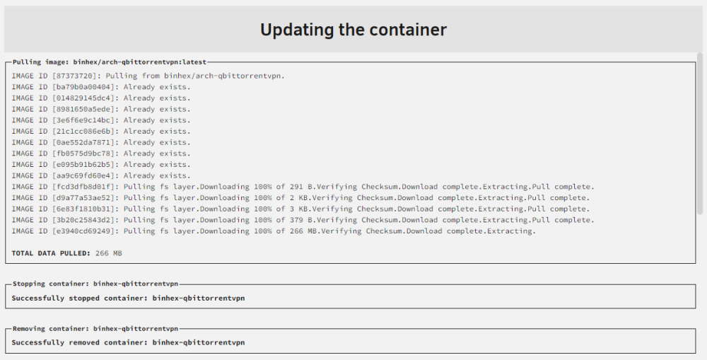

extracting.thumb.png.4089d918e1a7dc0ef6227c691928c4c0.pngPhil Barker if you look at the screenshot you posted updating qbittorrentvpn you will notice that the last line is extracting a 266mb image and it never gets to PULL COMPLETE (like as if the task has a timeout too short) and continues on to finish the whole task even though the last image never completed extracted.
This is where the problem is and I have several containers with the same problem and it always seems to happen if one of the image lines has something over 200+ mb that it needs to extract!!
Anyone know how to solve this?

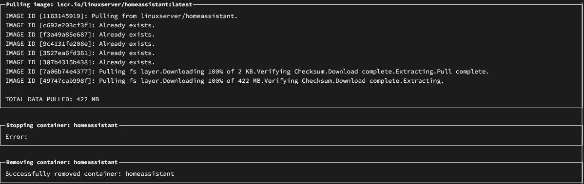

I am seeing the same with home assistant as shown below
I find that sometimes after a few automated attempts the update goes through but specifically with home assistant I still have issues. Trying to look into solutions when I have time.
