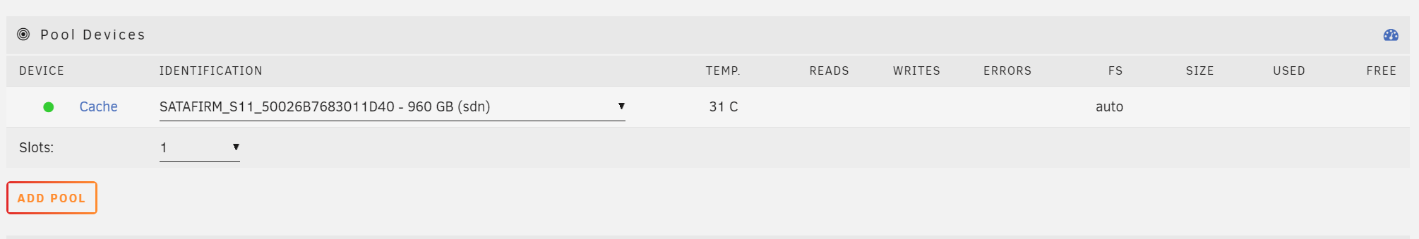

Re-connecting the disk and booting up the server gives this result (which seems fine):

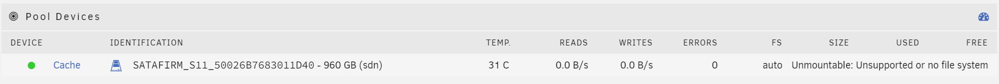

Starting the array however, results in this error: Unmountable: Unsupported or no file system

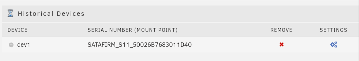

The disk is listed under "Historical Devices" as well

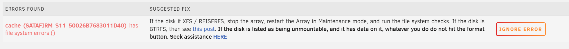

Under Fix Common Problems I get this error:
Where I fall into the latter category (If the disk is listed as being unmountable, and it has data on it, whatever you do do not hit the format button. Seek assistance HERE).
and it also lists a bunch of warnings, all referencing "non existent pool cache".
