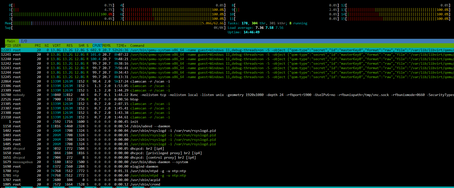

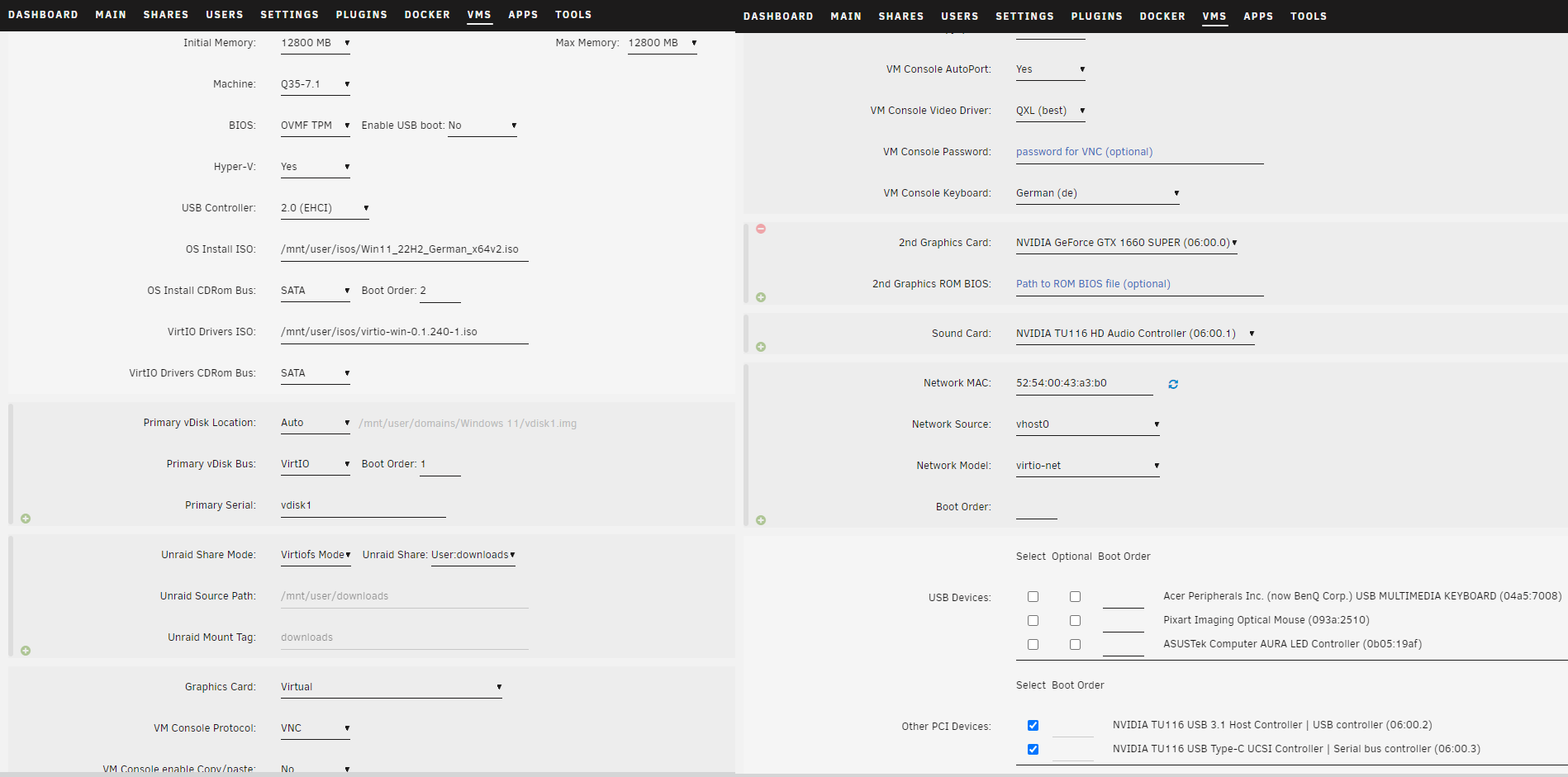

I have a problem with my VM. At some point this runs into 100% CPU utilization.
BlueIris and Jellyfin are installed on the VM. I also passed on a share and implemented it as a drive so that Jellyfin can access it.
At first I only installed BlueIris and didn't notice this problem. Only after Jellyfin or the share were set up as a drive did these problems arise. But it can also be a fallacy. I can no longer access via VNS or Windows remote access.
Does anyone have any ideas on how I can investigate this further?
image.thumb.png.925bd31bf8c79a99f991ce1d481e2f1a.pngimage.thumb.png.00c81de3b9e8540e91f68969609acc4b.png

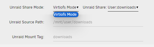

are you using virtiofs for the share, there is known issue which can cause this type of effect.
Yes
Is there another mode possible? In WIN11 via SMB is no option for me, because Jellyfin can't use SMB Oo

No 9p is only valid for linix. Could you use nfs?

I just wanted to point out that the topic has already been widely discussed. I just discovered that too late. Sorry for that. I also have the problem with the Windows VM that the Share implementation (VirtioFS) causes the resulting Windows freeze problem (CPU 100% and no response).
There is still no temporary solution right? I read there that a new Unraid release is needed, or did I misunderstood something?
AFAIK virtiofs is itself a bit beta on Windows - so that would have to get reliable first, not much unraid can do about it
Edited by Kilrah
No workaround currently, on my gitlab post someone said it looks like it was resolved with 7.2 and above. I expect next Unraid release to be using 8.1 release path.
