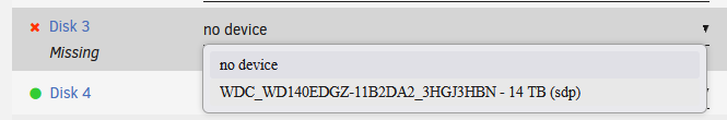

What should I do with disk 3?  Leave it with no device?  For reference, TOSHIBA_HDWE150 was the disk that failed and was replaced with WDC_WD140EDGZ.  WDC_WD140EDGZ was rebuilt and then I did a Check Filesystem to correct the issues.
There are 2 screenshots in your post that shows both of these. I assume one was taken before the rebuild?
Can you see the missing drive in BIOS?
Sorry, both of those screenshots are from after the rebuild.  WDC_WD140EDGZ was already rebuilt and is selectable from the dropdown as a replacement for disk 3.  I was just showing that it recognizes TOSHIBA_HDWE150 as disk 3, even though it was already rebuilt with WDC_WD140EDGZ.
That suggests it thinks the toshiba is still disk3. Did you make a flash backup after the replacement? Your array disk assignments are in config/super.dat (not a plain-text file).
