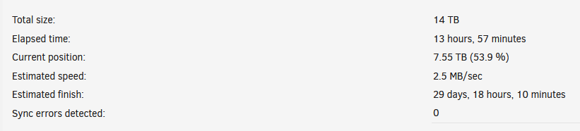

I've started running my monthly non-correcting parity check and it was going smoothly until about an hour ago.  Now the estimated finish is in ~30 days.  It looks like a lot of writing is happening to disk 3, but I don't know what is happening:

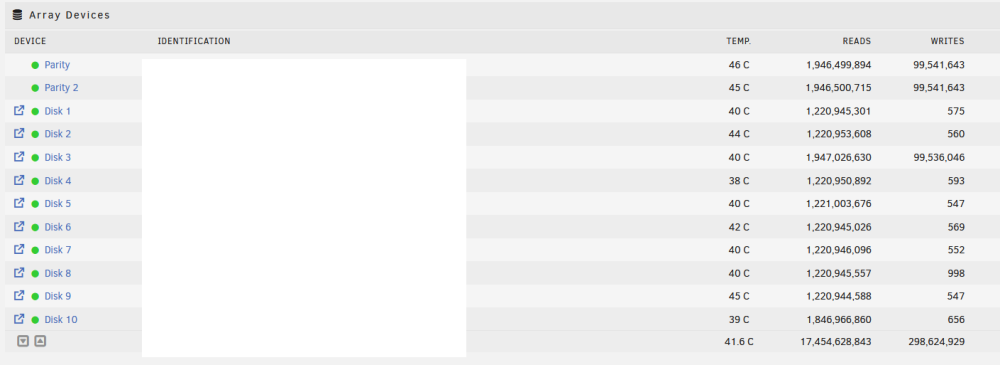

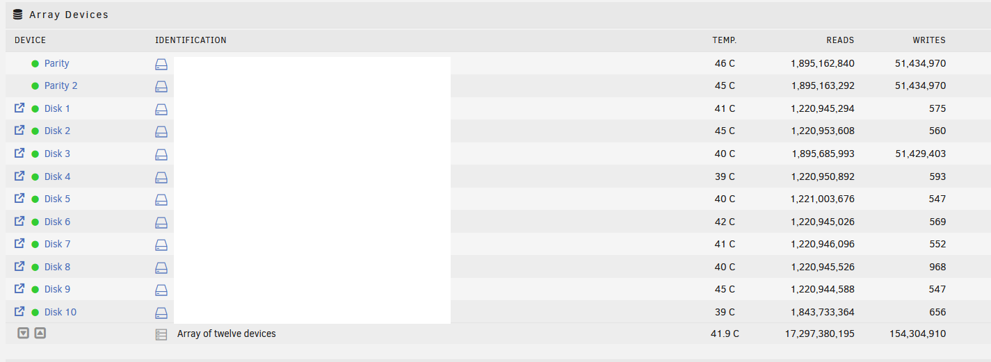

I'd like to note that writes to parity and disk 3 are continually increasing every second:

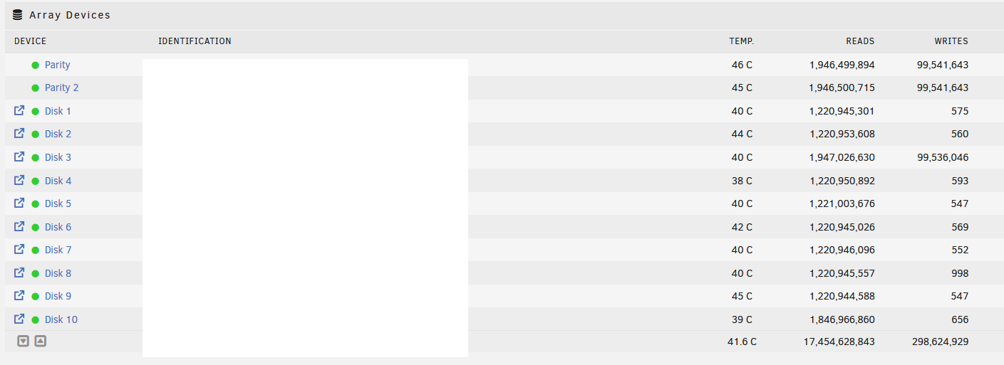

I think I found the issue, it looks like mover started running during the parity check.  I thought that couldn't normally happen, but that explains the writes to drive 3 and the parity drives.  I noticed the amount of free storage on my cache was increasing, so I paused the parity check and sure enough mover was running.  Once mover is done I'll resume the parity check and see if that solves the problem.
That ended up being the issue, parity check and mover were running at the same time.
