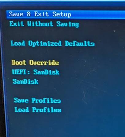

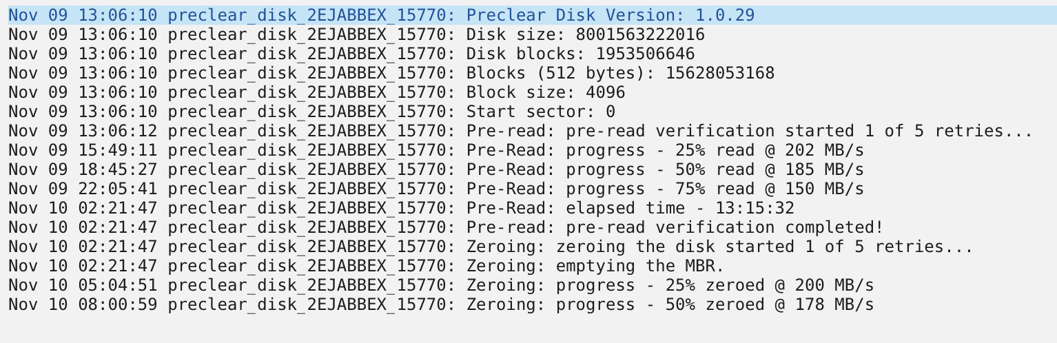

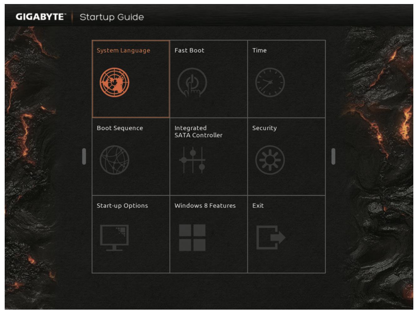

I see this over simplified bios screen. Seems like there used to be a much more standard looking bios screen. I'll play around a little more. I'm currently running a pre-clear on that renewed 8TB drive it's 56% through zeroing right now.

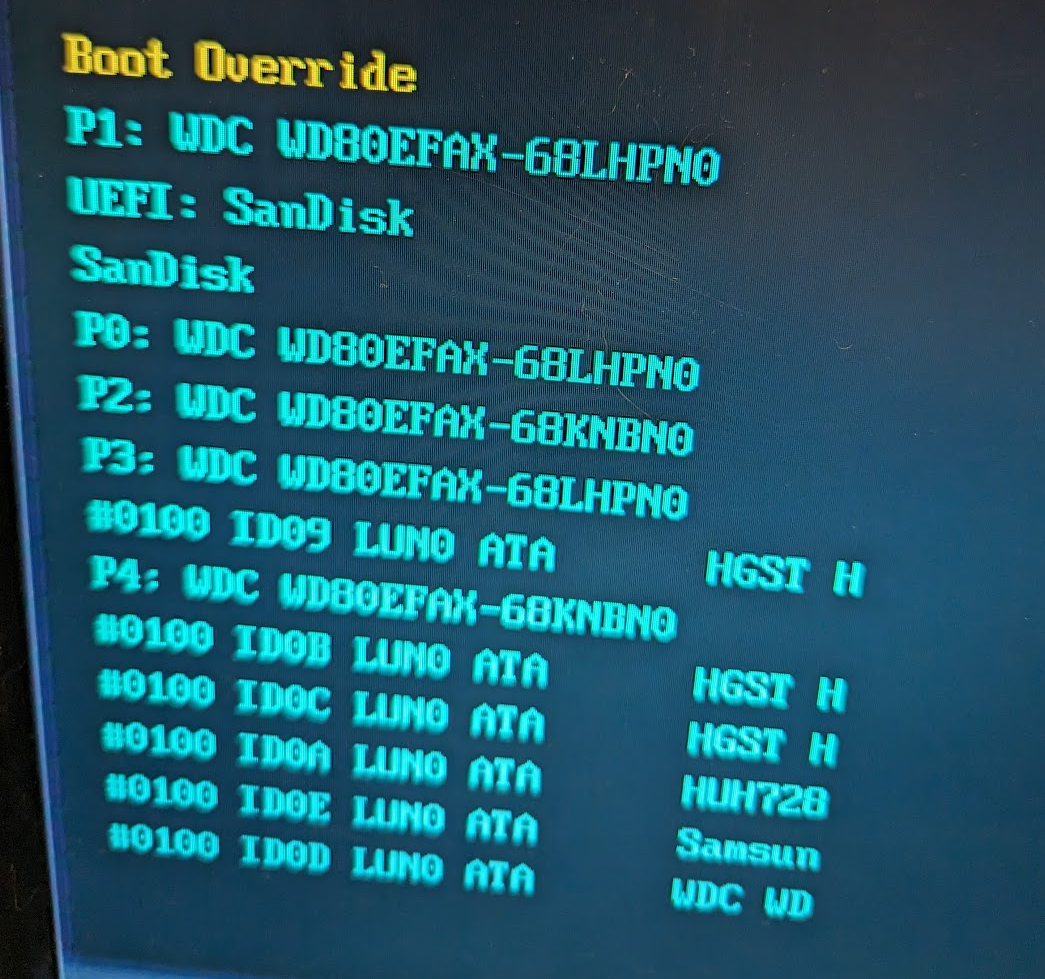

The pre-clear has finished, and I was able to find the classic bios mode. Disk 5 is not recognizable by the bios. I found where it showed the disks in the bios, unplugged all the disks and connected disk 5 to P4 on the motherboard. When I booted it back up it didn't see anything except the USB device.

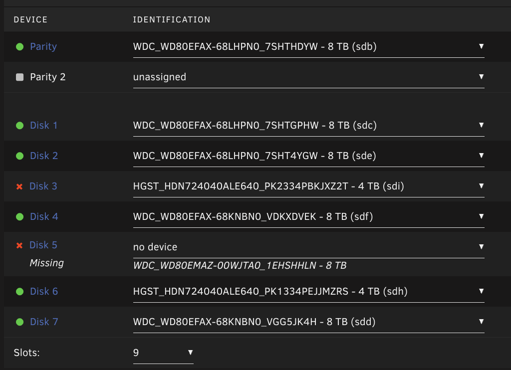

What's the best way to save most of the remaining data? I'm half tempted make the assumption that all the disks are fine except disk 5, and say just rebuild disk 5. Does that seem like a crazy solution? Is that even possible?

I assume disk3 is still disabled, how long as disk3 been disabled? Also post new diags.
Yes disk 3 is still showing as disabled. Disk 3 became disabled on November 7th, earlier in this thread. I haven't really had the array started much since then.

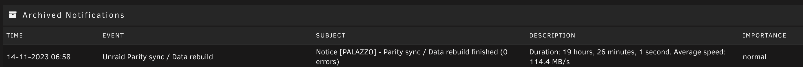

Emulated disk5 mounted, if contents look correct you can rebuild, stop array, assign new disk5, start array to begin rebuild.
Everything looked good on emulated disk5, rebuild has started, says about 13hrs to complete!
  • openam changed the title to (solved) unRAID 6.9.2 - /var/log is getting full (currently 100 % used)
Everything is back up and running thanks @JorgeB!
