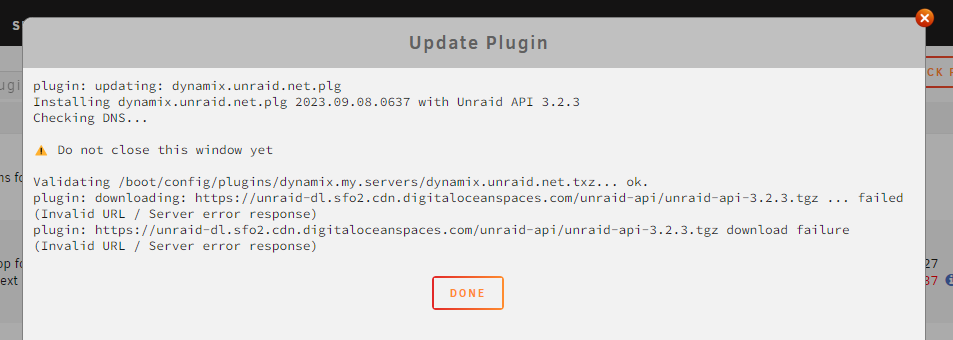

I am trying to update the Connect plugin and then complete the update to v6.12.4 but every time I try to update the plugin I get this error:
Validating /boot/config/plugins/dynamix.my.servers/dynamix.unraid.net.txz... ok.
plugin: downloading: https://unraid-dl.sfo2.cdn.digitaloceanspaces.com/unraid-api/unraid-api-3.2.3.tgz ... failed (Invalid URL / Server error response)
plugin: https://unraid-dl.sfo2.cdn.digitaloceanspaces.com/unraid-api/unraid-api-3.2.3.tgz download failure (Invalid URL / Server error response)

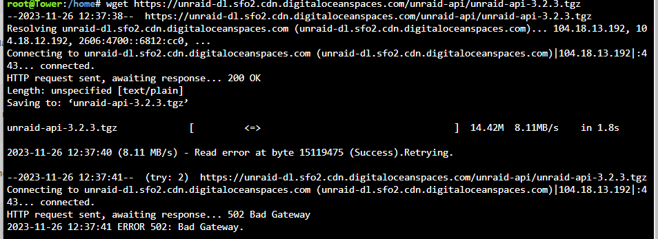

if I jump onto the terminal and use wget it appears to start to download the file quite happily then I get a read error followed by a 502 bad gateway.
