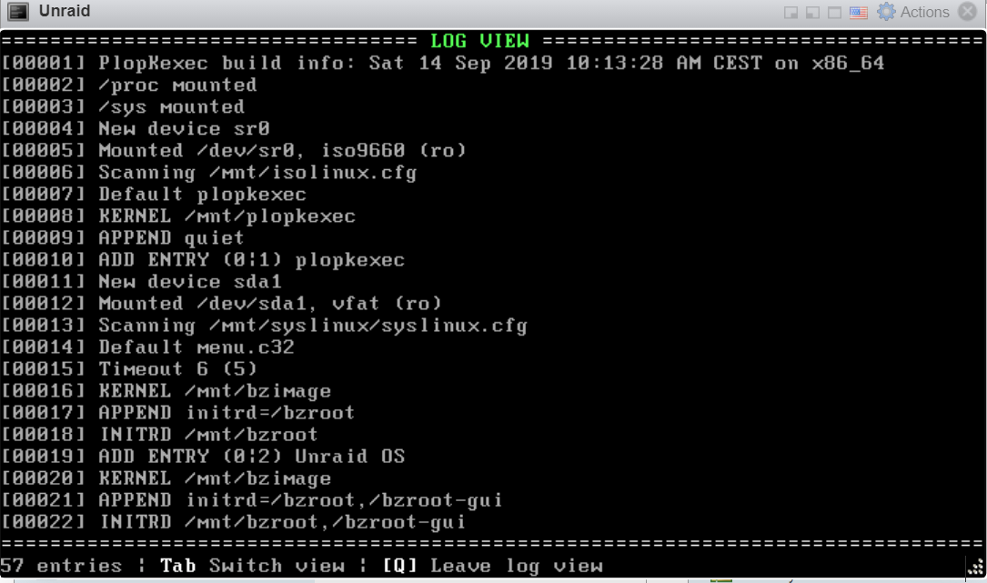

Does the system boot fine if you select one of the GUI modes from the boot menu?
Thanks for answering. Havent tried that yet, but out of interest why would it make a difference?
Because right now we don't know if the GUI can be loaded at all...

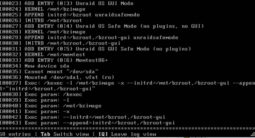

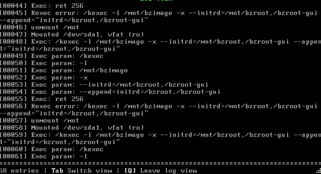

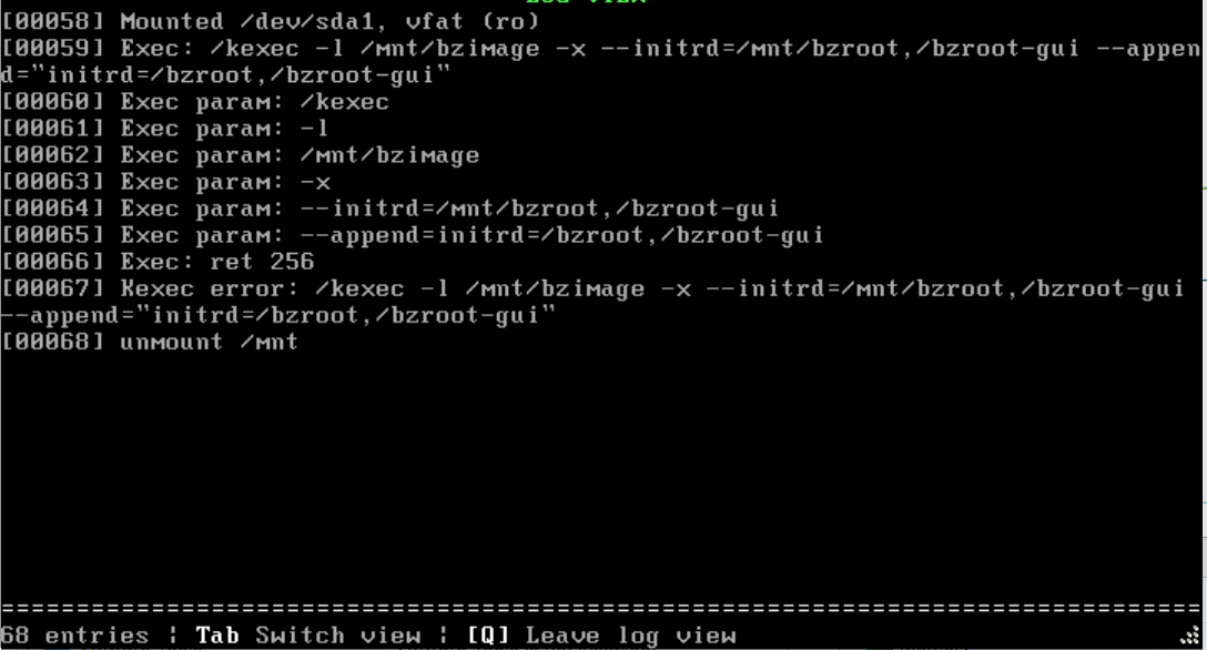

I then tried to shutdown the system and start GUI mode, it gives Kexec error.

Have tried with several USB keys to test both EFI and legacy. It wont boot from GUI.
I don't know what that error refers to.  I'd surmise though that you should try remaking the flash drive again via USB creator.  And then see if it'll boot as completely 100% stock
