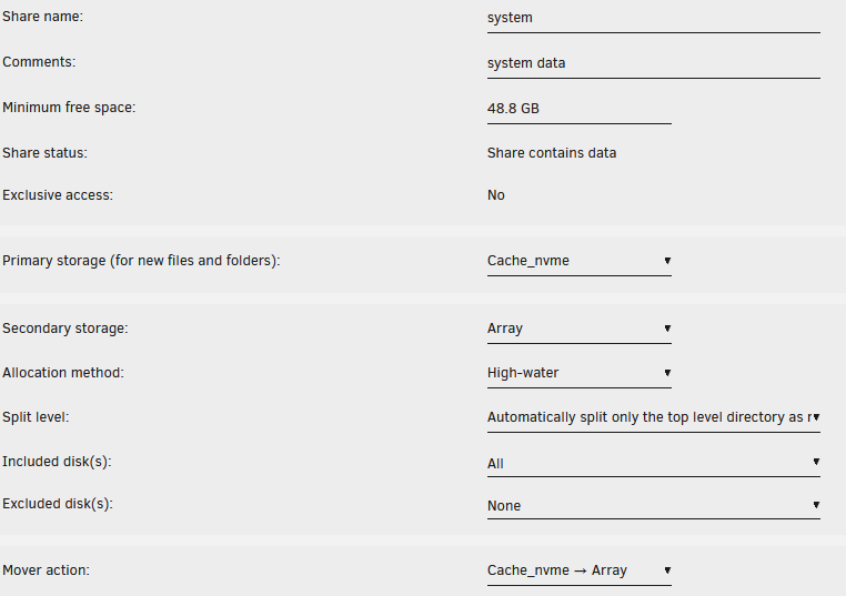

And here are the settings for the system share:
