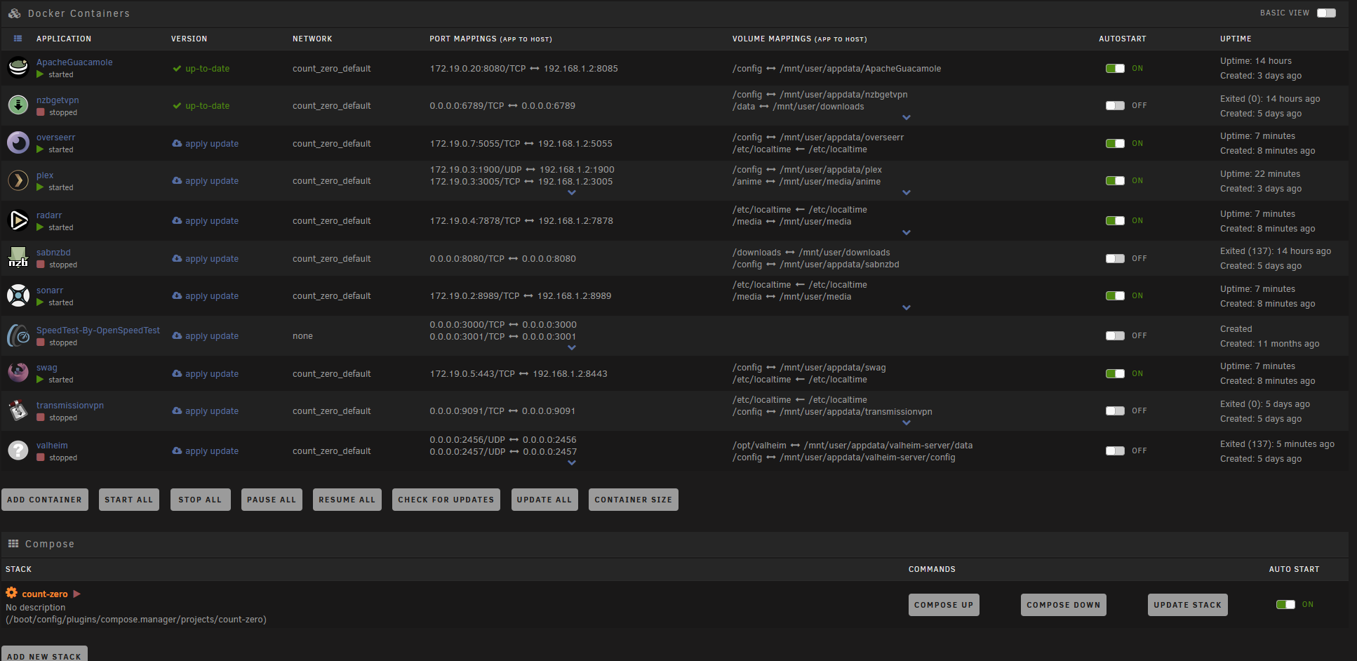

December 9, 20232 yr I'm using the Compose.Manager plugin so I can use docker compose stacks instead of individual docker containers as this was how my server was set up prior to migrating to unraid. I am able to update the stack using the 'Update Stack' button, but the Docker tab still says there are updates available to most of my docker containers. If I click 'apply update' on a container, it breaks the stack and that container no longer functions properly (I suspect because it's performing the update outside of the stack). While this isn't a big deal, it is slightly annoying that I get pinged every day for updates that I can't apply. It seems like Compose.Manager and the standard Docker plugin pull updates from different sources. Am I correct in thinking that? Is there any way to either disable the update check for containers in the stack, or to tell the Docker plugin to look at the Compose file for updates? cherry-diagnostics-20231209-0759.zip

December 14, 20232 yr Solution On 12/9/2023 at 8:00 AM, count-zero said: It seems like Compose.Manager and the standard Docker plugin pull updates from different sources. Am I correct in thinking that? No, the Dockerman system has its own method of storing the current and latest available version of docker images. Compose.Manager does not integrate with Dockerman in this respect (in fact it does no update tracking of its own it just provides a button with runs a stack update command). On 12/9/2023 at 8:00 AM, count-zero said: Is there any way to either disable the update check for containers in the stack, or to tell the Docker plugin to look at the Compose file for updates? No, at the moment there is no good way to remove the "Update Available" link. On 12/9/2023 at 8:00 AM, count-zero said: While this isn't a big deal, it is slightly annoying that I get pinged every day for updates that I can't apply. The pings are from the Fix Common Problems plugin correct? Best to just disable the update check in FCP.
