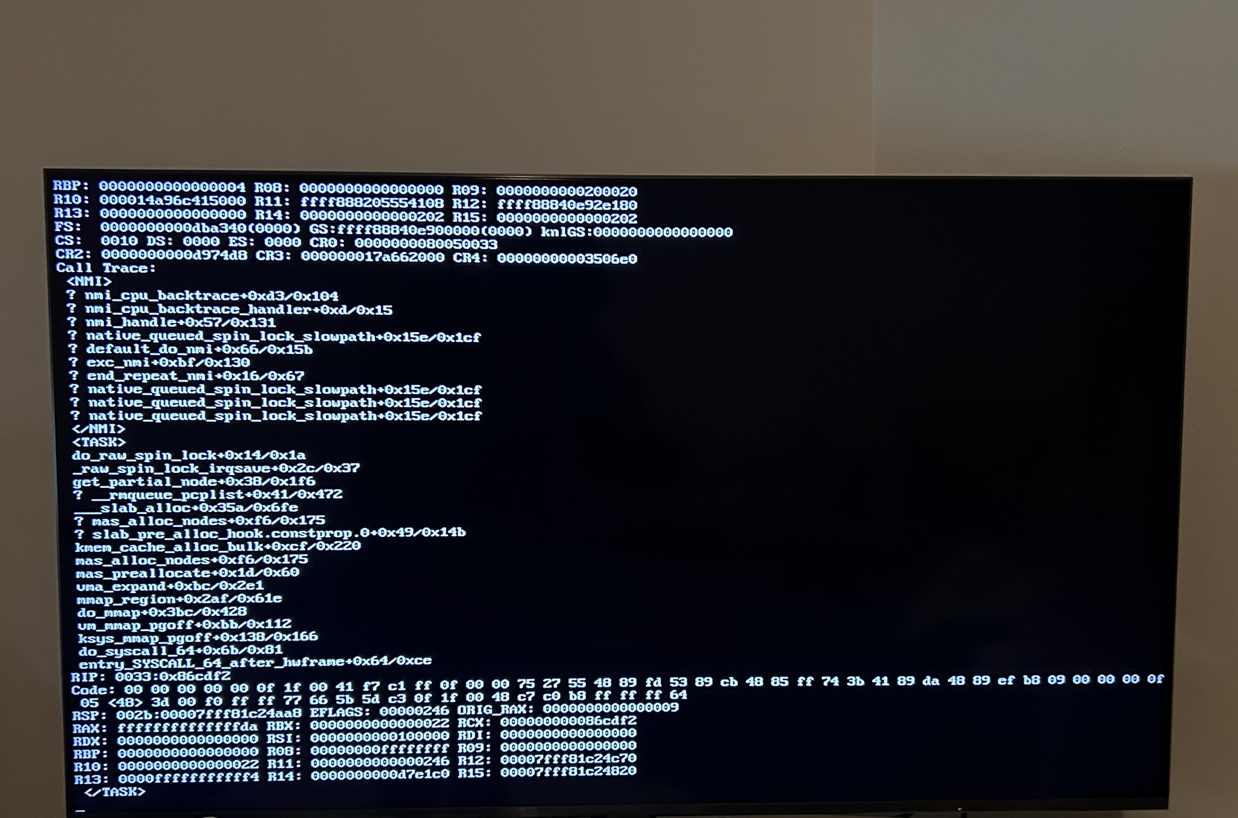

While I wrote, the system crashed and it didn't reboot.
I took a picture of what I have.

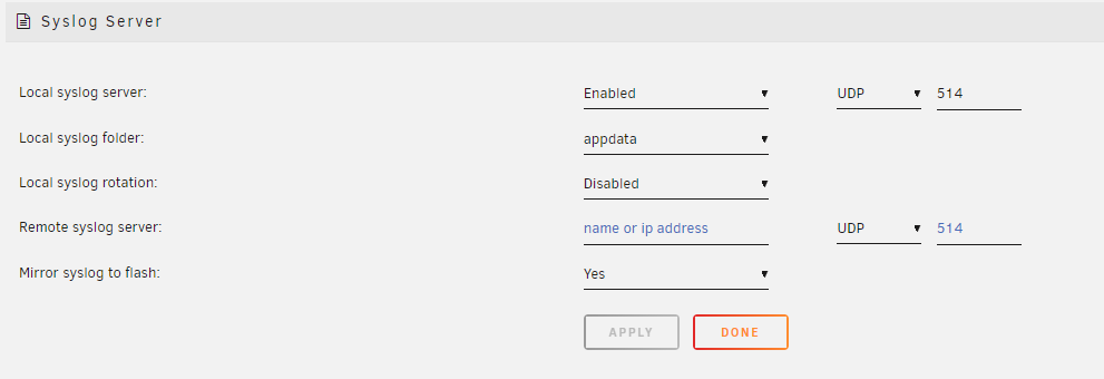

That's how i setup the syslog server : image.png.3b141ebfd08fd7bb133652a57fe9c360.png

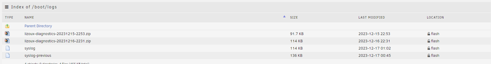

With those settings the syslog file that survives a reboot will be put into the 'logs' folder on the flash drive.
Yes, the syslogs files that i gave before were from the 'logs' file on the usb key
Then that is strange as if that was the case they should have included information from before the crash whereas they seemed to only include information since the last boot.
The server just crashed, i looked at the syslog-previous and the last line is my connection by the Web..
I can give you both logs files.
syslog-previous syslog
Both of those are just after reboot. How did you get them?
It doesn't seem like we have gotten any syslogs from before reboot, unless all you are doing is rebooting and then it crashes before you do anything else with the server.

When I have the problem, the server is rebooting itself (only the Unraid, not the server) or the server freeze ( like the picture i sent earlier ) and the only thing I can do is to shut it down and start it.
I got them on the USB key, look at the picture : image.thumb.png.7f1acdd7d09d67ba6b1e603796c6cee9.png

Server rebooting on its own, versus hanging or crashing, usually always means a hardware (or power) problem, and not surprisingly, there's nothing relevant logged in the syslog.
Ok, thanks, so I have to change the PSU ?
