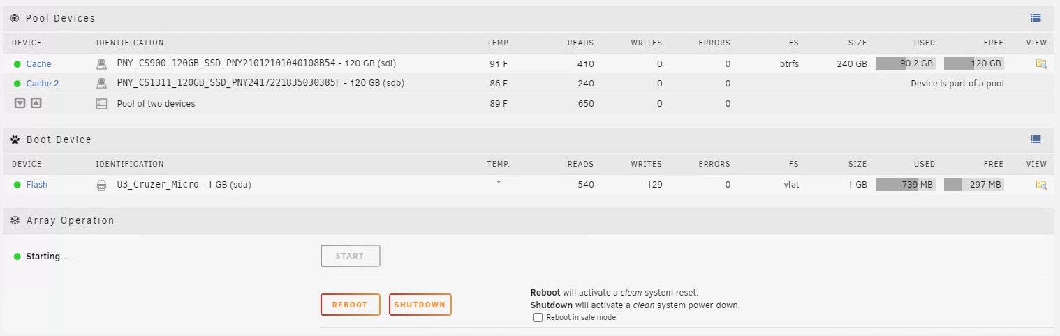

I decided to add a additional identical cache drive as raid protection for cache 1.  After adding the drive and rebooting, I selected the new drive to 'cache 2'.  Once I clicked 'start', it just hung on 'starting...'.
After 10 hours I decided to reboot.  The array still wasn't started, but now 'cache 2' was also green ball. I clicked start, and again, just hangs on 'starting...'.  I can access my unraid data across the network, including the cache drive, but the array hasn't started, so no Docker or VM's.  Shares are working though.

BTW, here is how it still looks.

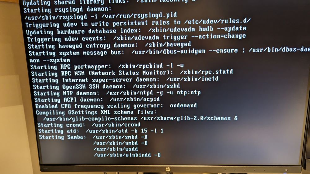

Ok, did a hard reboot.  Forgot to mention that it won't boot unless in safe mode.  It hangs on Starting Samba (see attached photo).
