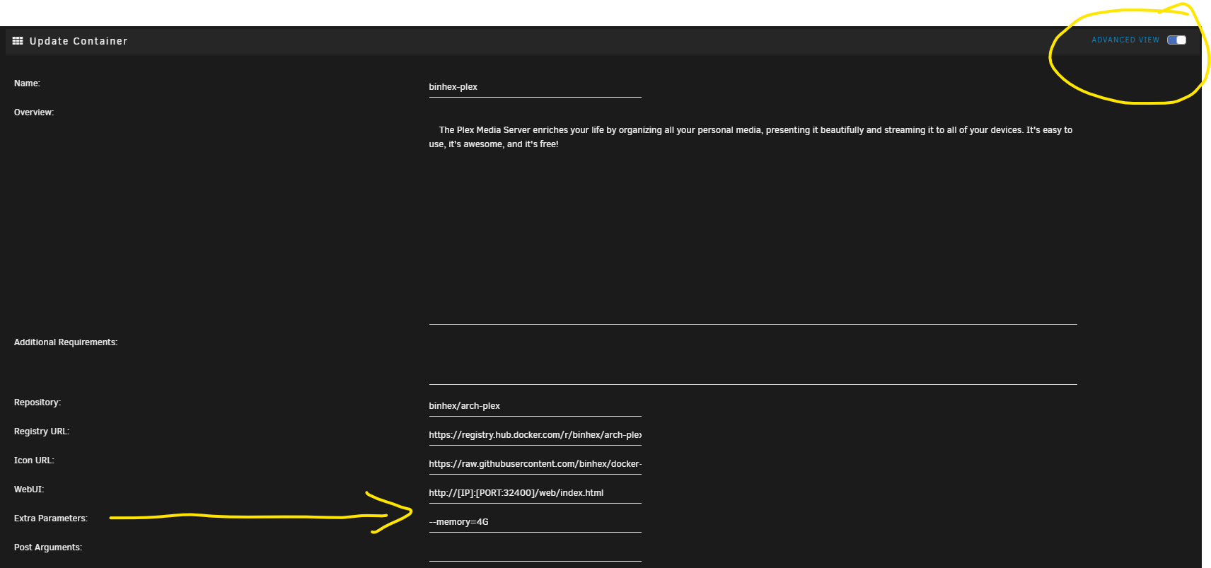

Honestly I got busy with other things and forgot about this. Additionally, I'm not quite sure how I go about limiting Plex's memory in the container settings.
In the container's settings, toggle advanced view and add this into the extra parameters field (whatever amount of RAM you want to limit to, I just use 4G
