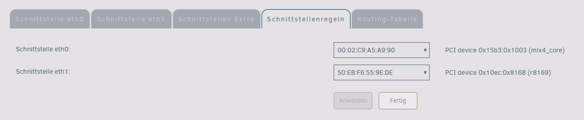

Usually you can use the "network rules" section (or tab depending on you gui settings) to switch the MAC addresses of the cards.
Make the 2.5G one first, so it will become eth0. Thats enough. (and dont assign addresses, the automatic usually works better).
Beware: NEVER connect two cards to the same network at the same time! (unless you use bonding, but thats complicated and usually overestimated, so forget it)
Just select the other card from the pulldown list that opens if you click on the downarrow box with the mystical numbers 00:02:...
BUT: using an USB adapter is not the best idea. It maybe unstable.
