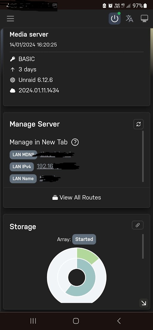

Anyways, I am very new to Unraid and very much rely on reading tech setup forums or watching youtube guides to get me to where I am at with Unraid. Everything is on track except, I cannot for the life of me work out how to get Unraid Connect to work.

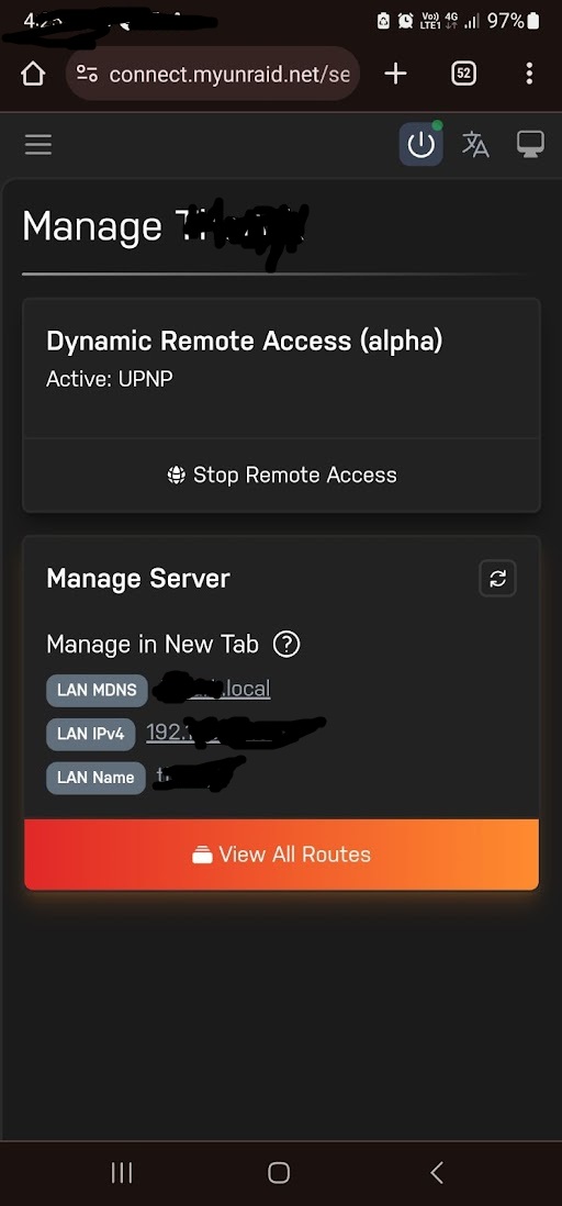

I have UPnP turned on my Deco XE75 router and thought it should be pretty straight forward to access Unraid remotely. I can sign into and see the 'My Severs' page remotely, turn on remote access successfully but when I try to click to gain access, I fail to anywhere with a 'this site can't be reached' page.
  • Using Unraid 6.12.6

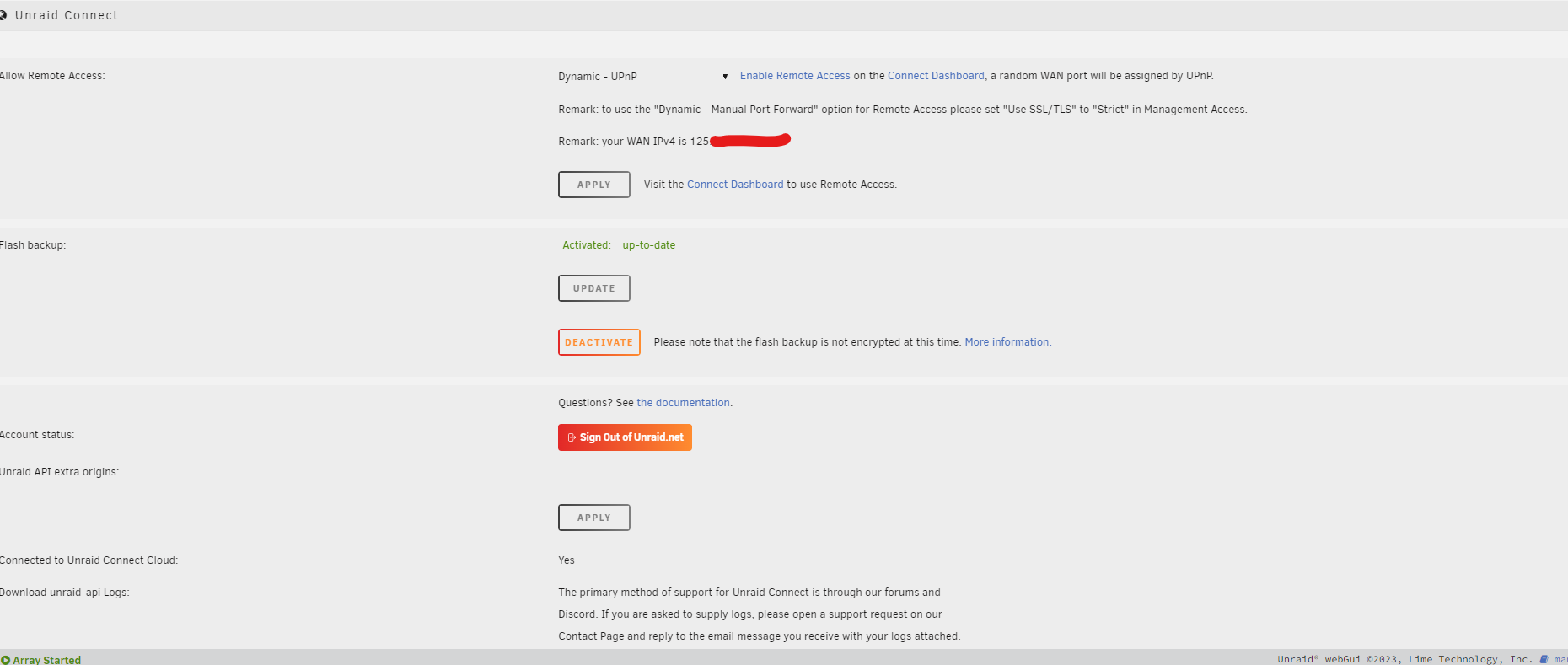

  • UPnP is switched on under Management Access
  • UPnP is switched on within my router
  • Selected Dynamic - UPnP
  • Unraid Connect works locally but not remotely
  • Tried the other 'Allow Remote Access:' options but nothing worked

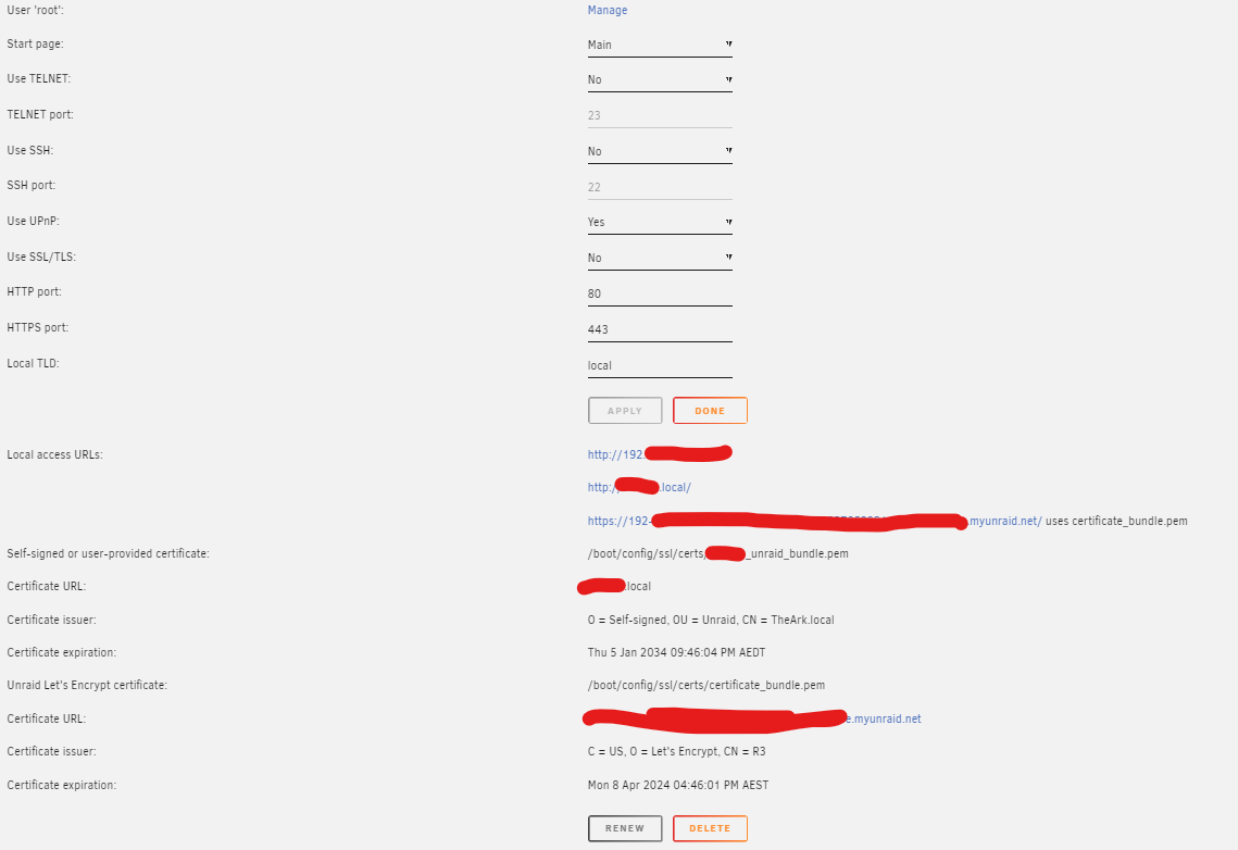

I have use SSL/TLS on.
I also have the destination port (server LAN IP) 192.xxx.xxx.xx:443 forwarded on my router for one of my docker containers.

@CcHookeye that sounds borderline traumatic. sorry you're dealing with that. just as a sanity check, do you have both 'Use UPnP' and 'Use SSL' set to yes on your unraid server?
