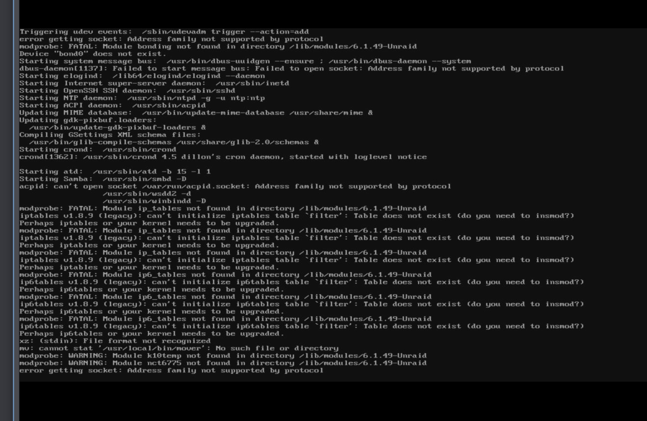

1) Repeating update problem:
Every time i update my server i can't access it afterwards no matter how much time i wait. The only way is to format the usb and copy all the contents from a previous backup back in, then it always -strangely- seems to be upgraded: version number is updated in the dashboard and everything works as expected ( the second problem may or may not be connected with this, read point 2 ).
But of course it's a pain to know that everytime it's the same story, and moreover my piKVM shows this, which seems... not fine:
255265092_Screenshot2024-01-17alle14_35_30.thumb.jpg.360c999482321dbcfdb72249d3d0b9a3.jpg
The screen you see it's 20 minutes after the last -failed- update 6.12.4 to 6.12.6 and it's very similar -if not the same-  to what i've always seen after an always unsuccessful update. This happened since forever since my first unraid install ( 6.12.5 or .4)
- First and foremost: Correct way to get the server back up? Do i reinstall from backup as i always did or now it's the time to intervene?

No idea what the 1st issue could be, never seen it before, you could try recreating the flash drive, backup the current one first and then redo it and just restore the bare minimum, like the key, super.dat and the pools folder for the assignments, also copy the docker user templates folder, if all works you can then reconfigure the server or try restoring a few config files at a time from the backup to see if you can find the culprit.
