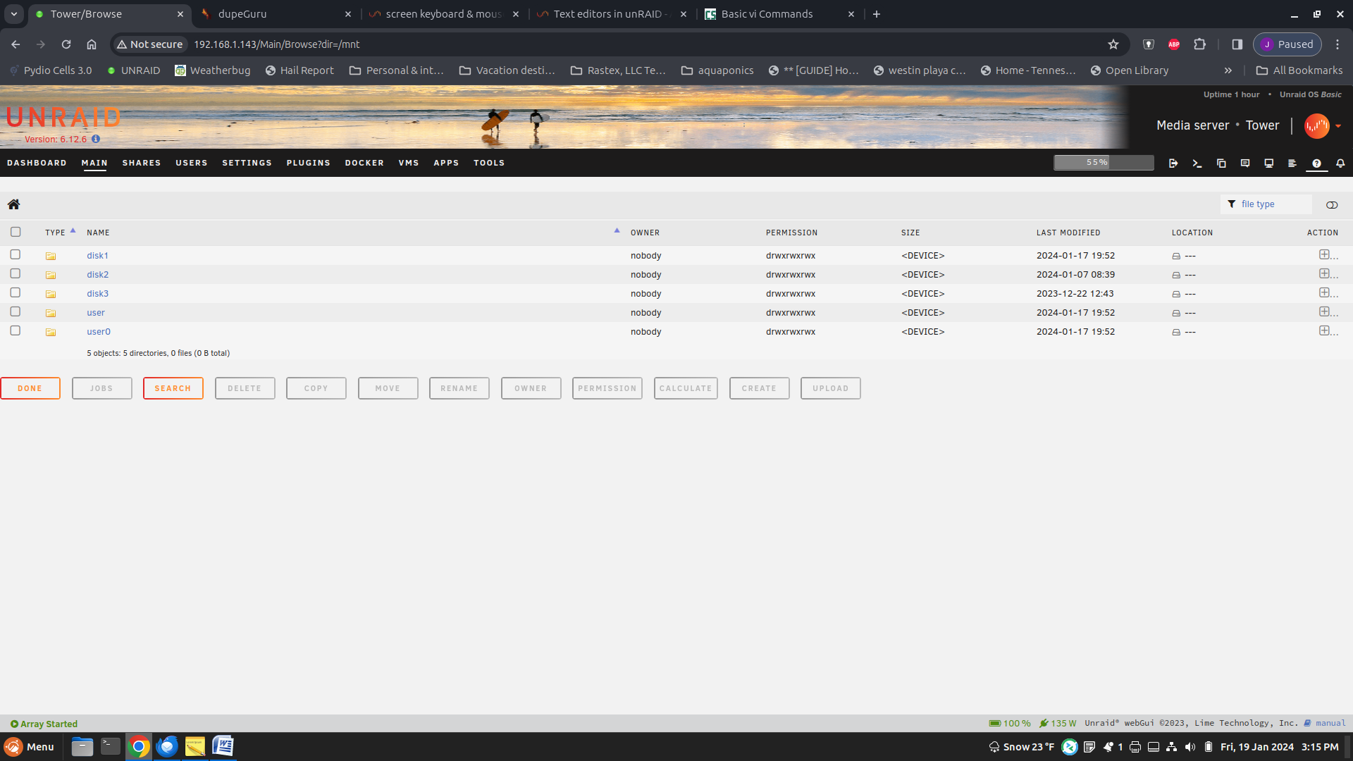

The drives are there but not the USB stick.  I attached a pic for simplicity.  If there is a way to expose the root of the system to Dynamix, I would like to know how to do that.  There are some tweaks I would like to research on the underlying OS in the future.

maybe I have to add/change SMB permissions on the USB stick 1st???
As I said have you gone to the ‘Boot Device” section of the Main tab?   The screenshot is only the ‘Array Devices’ section of the Main tab.
i did try boot device then clicked on file manager... that was the result (attached screenshot)
I wonder if I have to add SMB permissions to see it listed?
ill try it.
nope that didn't work.
Not a big deal I can use the terminal on the main tower if needed.
Not quite sure why it is not working for you?   I click on the leftmost icon for the flash device and it takes me into a view showing the folders and files on the flash device.     When I navigate to the config folder and click on the ‘go’ file it opens it up for editing.
aha...left most icon.... sweet thats how that works.  Yes I see it now.
Thanks itimpi.  Learned something new today.
