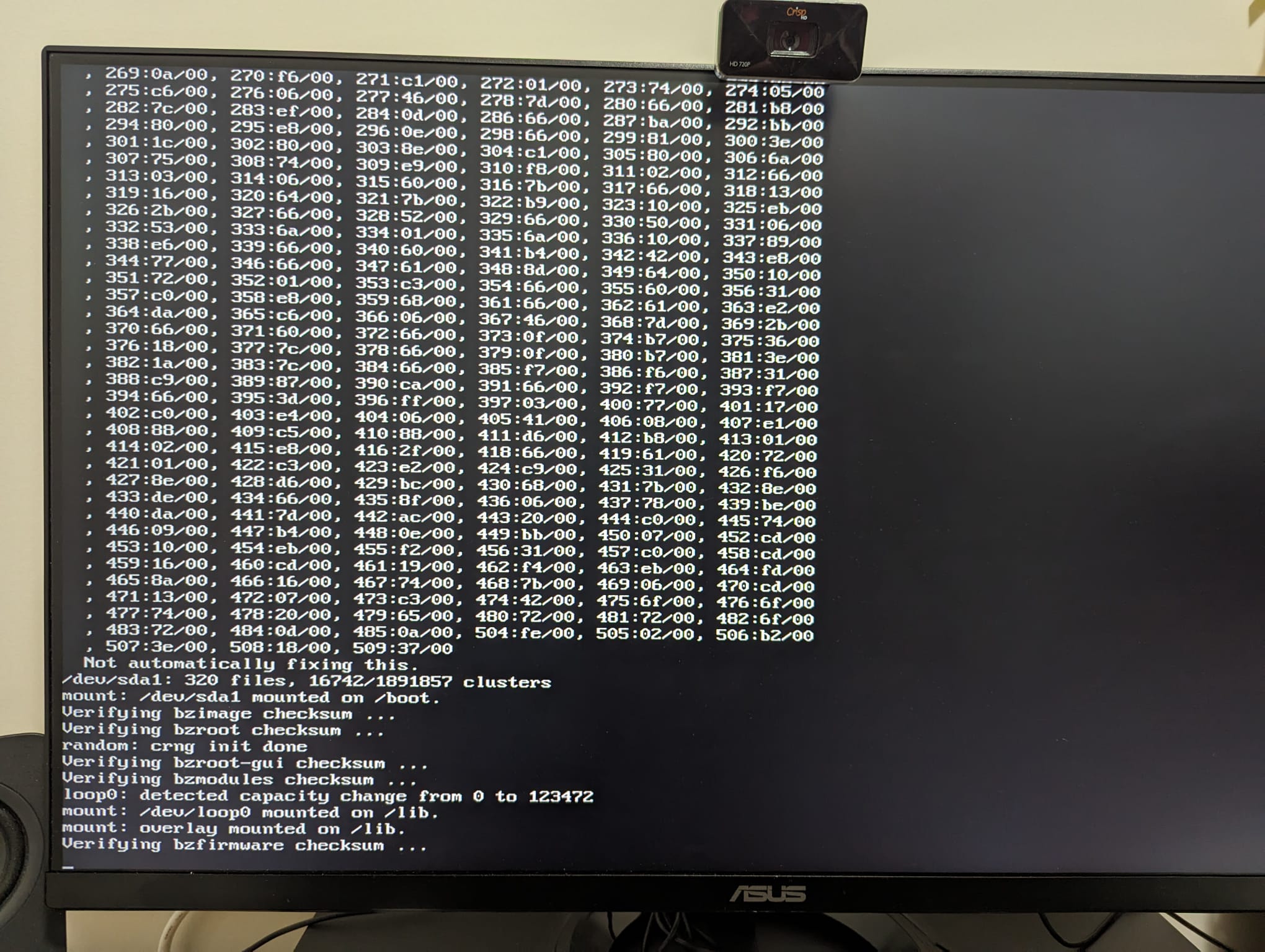

I also noticed that during boot there are these number list (my guess memory block list) which reads so:1312504590_WhatsAppImage2024-01-19at18_27.42_67defd3d.thumb.jpg.621740392244c319ccc3ac81e18a95c7.jpg

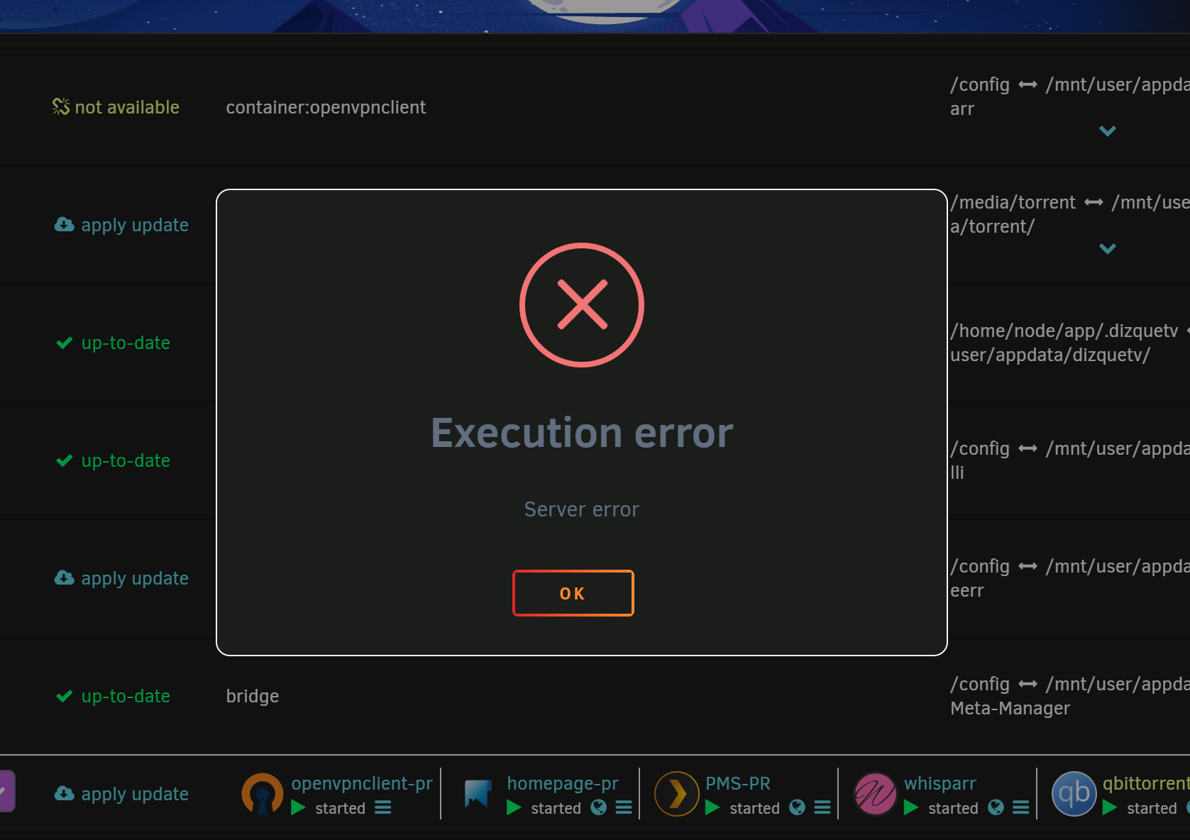

I don't understand what this is. Then the situation worsened. Now, docker containers would just randomly stop working and when tried to restart them, I would receive popup either saying "403" or "Execution error". I then either had to restart the docker service or the whole server to be able to get them to work. My guess was that the docker file is corrupted. But I couldn't still act to fix that due to life.

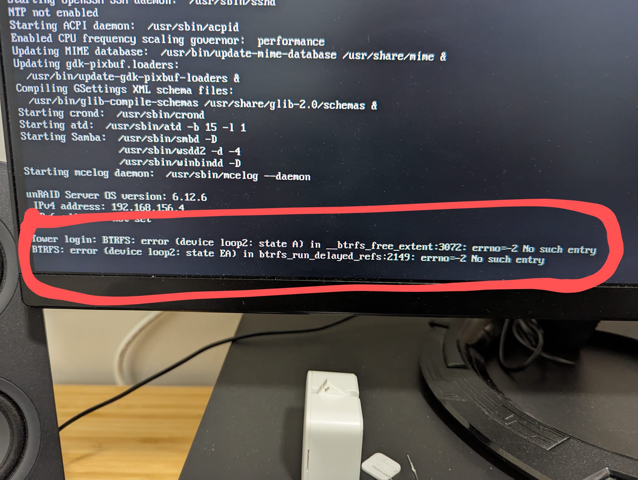

Also, when I clicked 'Download' on the diagnostics page, I saw the following error on the server cli screen:
433642651_WhatsAppImage2024-01-19at18_41.14_56818d66.thumb.jpg.6a4d31598ad098bba211e1a47073ca74.jpg
Docker image is corrupt, delete and recreate.
