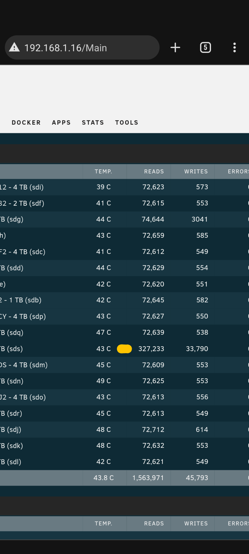

At the moment there appears to be something writing to disk16 which will be slowing things down
Interesting. I did notice reads and writes are much higher on that disk, and climbing slowly.
