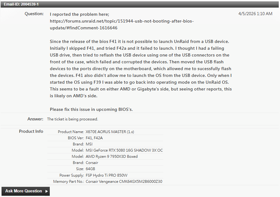

I can confirm this issue also affects the Gigabyte X670E AORUS Master, and the failure goes beyond just blocking USB boot.
After updating to F42a, Unraid would no longer boot from USB. Rolling back to F41 did not fix it. Only after downgrading to F39 was I able to boot Unraid again.
Here’s the BIOS progression:
  • F42a (Mar 2026)
    • AGESA 1.3.0.0a
    • DDR5 vulnerability fix (CVE‑2025‑6202)
    • Result: Unraid USB will not boot.
    • Additional issue: All front‑panel USB ports became unstable. I could not reliably format, flash, or write to any USB drive connected to the case ports. Attempts to repair the Unraid boot device on those ports failed completely and even caused corruption.
    • Only the rear motherboard USB ports were stable enough to restore the boot device.
  • F41 (Feb 2026)
    • AGESA 1.2.8.0
    • Result: Unraid USB still will not boot.
  • F39 (Dec 2025)
    • Pre‑2026 AGESA
    • Result: Unraid boots normally again. USB ports behave normally.
Based on this, it appears that all 2026 BIOS releases for this board break UnRaid USB booting and likely also other AMD AM5 boards, likely due to AGESA changes and new security hardening. The USB instability in F42a suggests deeper changes to the USB initialization stack, not just the bootloader path.
For anyone troubleshooting similar symptoms: F39 is currently the last known‑good BIOS for Unraid on the X670E AORUS Master.
I've sent out a message to LimeTech and will also send out a message to gigabyte regarding this problem.

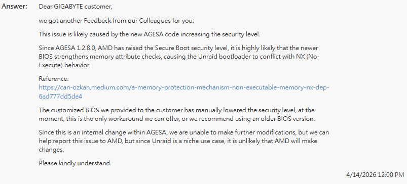

On 4/5/2026 at 9:48 AM, JorgeB said:
Yep, this was also the feedback I got from unraid.
But just to add to the topic, I did receive a custom bios from gigabyte based of F42a, which allowed me to boot with the existing bootloader.
Here is the message I received after confirming that this modified bios worked;
