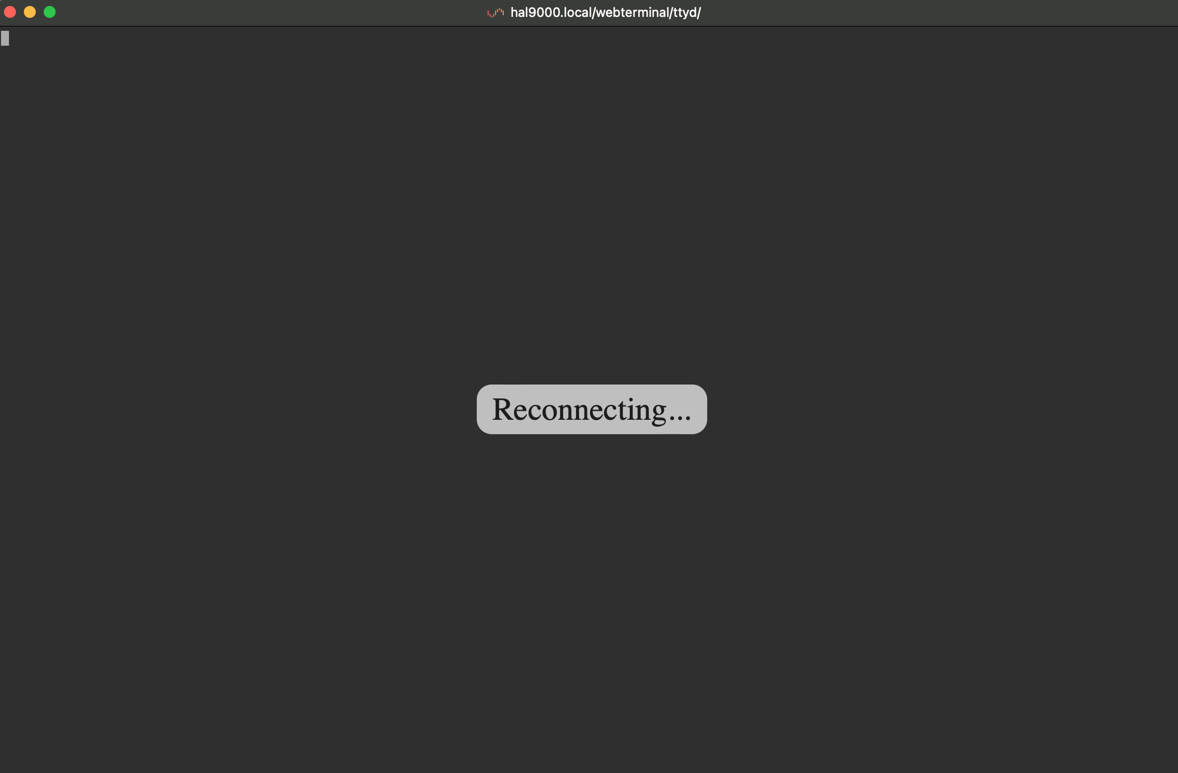

From Safari, the window actually has something in it: "reconnecting" which blinks rapidly:
574371229_Screenshot2024-02-14at3_49_54PM.thumb.jpg.832c630ff3991306bfabc4db2a64b723.jpg
Weirdly this went away when I restarted my mac laptop. No idea why restarting the client (not the server) would affect this, but glad it's resolved!! Hope this helps someone else!

Oh no - this is back! And restarting my laptop isn't fixing it anymore. I just get this constant "reconnecting" message again (see below).
I am able to use the terminal & logs fine with a different mac laptop though. Also I should add that this issue, whatever is causing it, also prevents me from connecting to VMs via VNC. I just get a "Failed to connect to server" error in VNC.
Also attached diagnostics although I imagine they won't be relevant since this is clearly a client side issue.
Lastly, one other thing I've tried is switching from my 10GBE ethernet wired connection to the router to wifi. I thought maybe there was some issue with the 10gbe connection, but wifi did not resolve the issue.
216774466_Screenshot2024-02-22at10_00_02AM.thumb.jpg.32da6b393a1881c2843d65f0ad922550.jpg2001315081_Screenshot2024-02-22at6_18_44AM.thumb.jpg.254a4b91142c09ae9083d8f0d750a179.jpg
