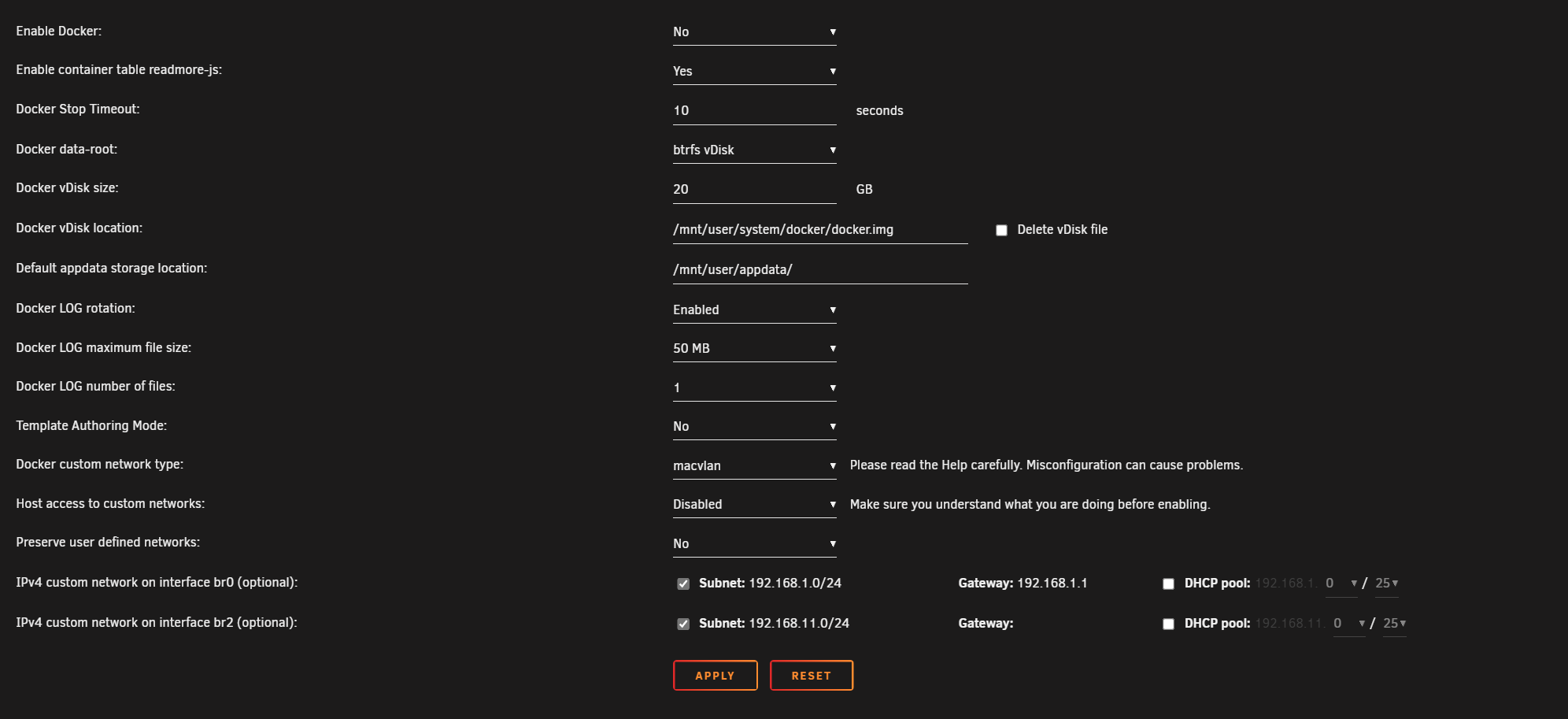

Also, now my docker settings are change.  1. Enable docker - changed to No. Was yes before. 2. Docker vDisk size changed to 20gb - was 30gb before. 3.Docker custom network type changed to macvlan - was on ipvlan.

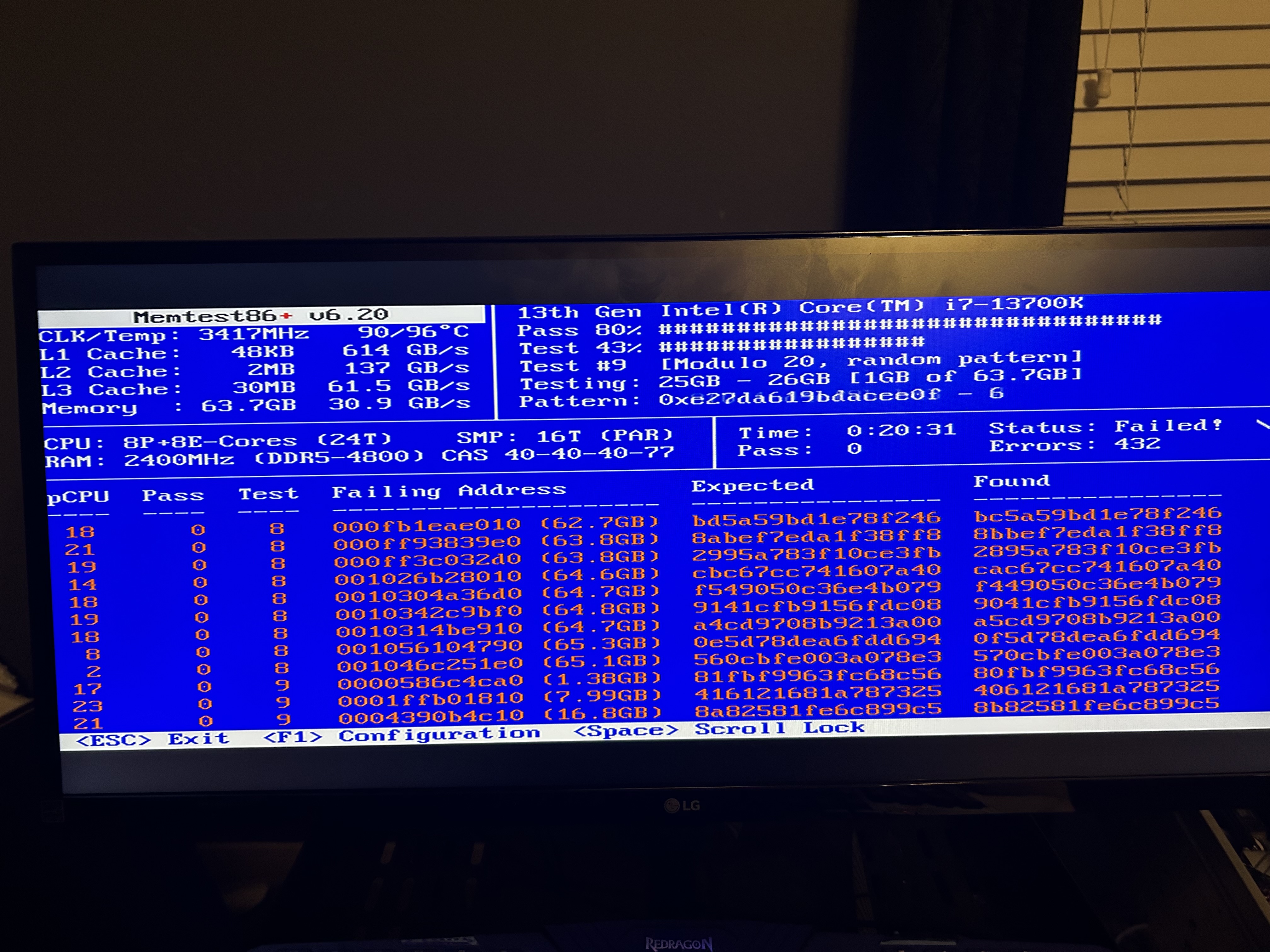

There are segfaults and multiple call traces logged, suggest starting by running memtest.
Running Memtest86+. Test is still running and I have a lot of errors. This is the first time I have had error on a Memtest. I currently have 4 x 16gb sticks. Do I need to remove 3 and start with 1 and run the test again. Adding one stick at time to find the cuprite?
It's worth a try to see if you can find the culprit.

I have tested all stick independently and they all pass. Do this mean it is most likely a motherboard memory slot issue?
Not necessarily - it can be just the case that when all of them are plugged in the motherboard controller cannot handle the load of the total throughput required.  This is one of the reasons many motherboards quote a smaller maximum RAM clock speed if all RAM slots are populated.  Have you checked both the motherboard manual and the CPU spec to see if either of these imposes such a limit?
The motherboard is the Asus Prime Z790-P WiFI D4. The memory is G.Skill Ripjaws S5 32GB (2 x 16GB) DDR5-6000 PC5-48000 CL36 Dual Channel Desktop Memory Kit F5-6000J3636F16GX2-RS5K - Black. Processor is Intel Core i7-13700K Raptor Lake 3.4GHz Sixteen-Core LGA 1700 Boxed Processor. Purchased as a bundle from microcenter.
