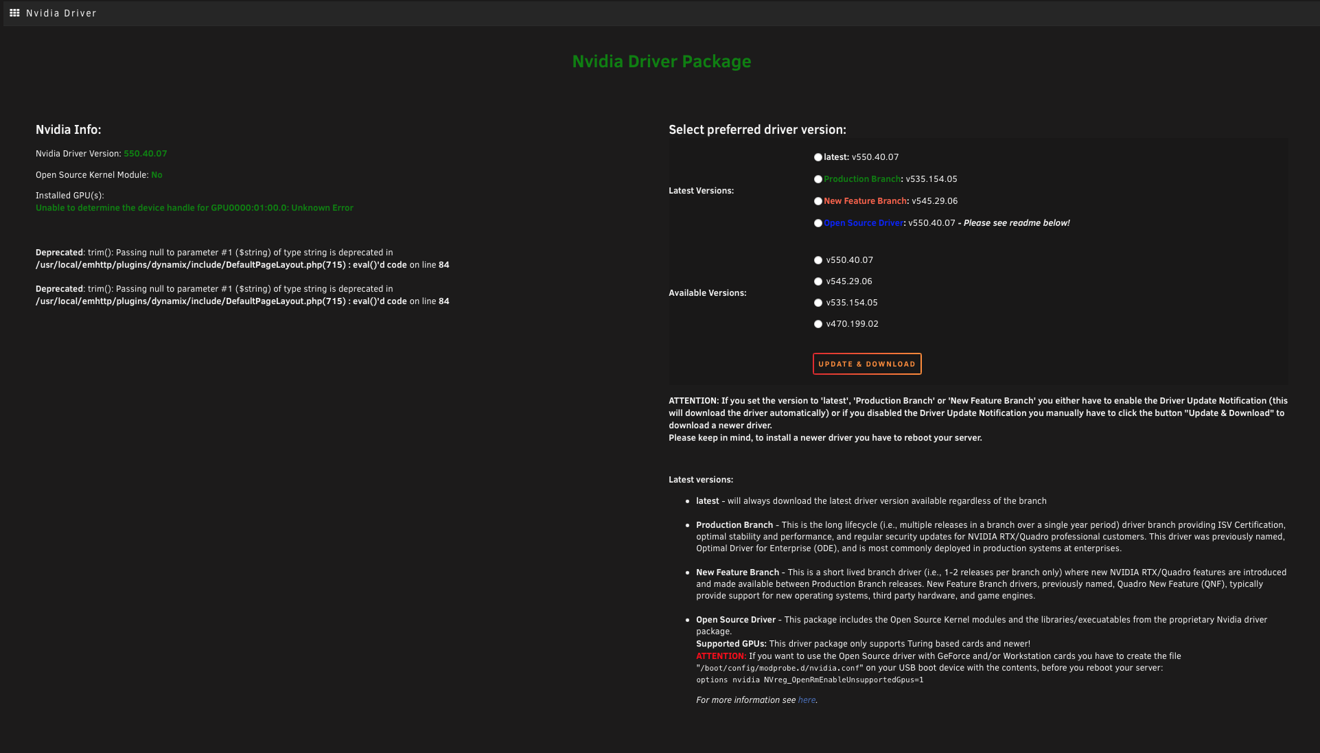

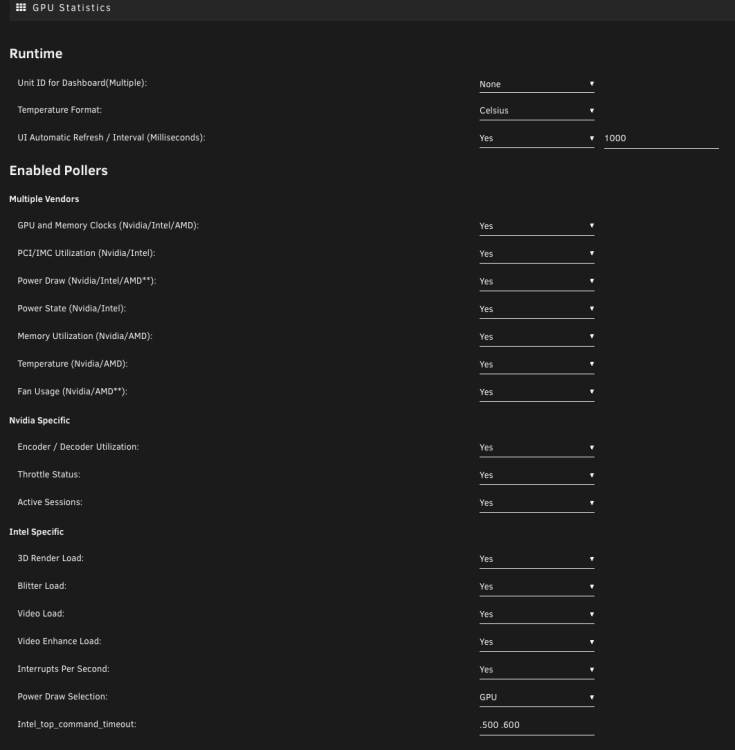

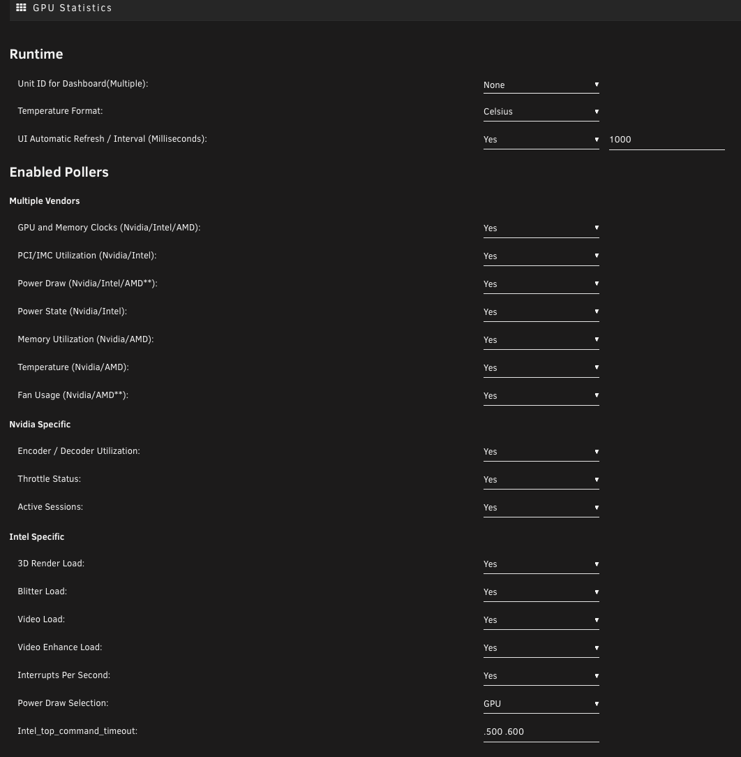

I do also notice that I get a failure on the GPU plugin in Unraid on occasion.  Do I need to disable the onboard video now that I am running the Tesla P4?Or do I have a bad GPU as well?
